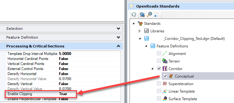

I've added a shape as a clipping references but when I attempt to clip the corridor nothing happens and the corridor components are not clipped. How to resolve this?
Answer:
Open Explorer>OpenRoads Standards>Feature definitions>Corridor and ensure the corridor feature definition property Enable Clipping=True.
