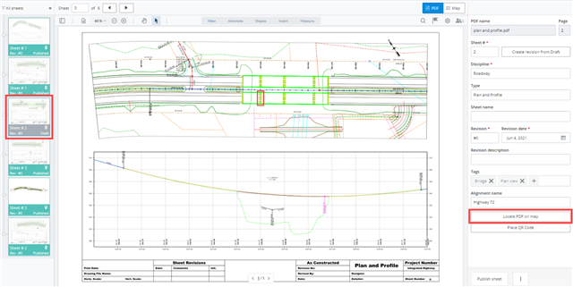

  1. Select on the PDF Sheet, then click the Load PDF on map.
  2. If the PDF is spatially located it will calibrate, locate, and position to the correct location on the map.

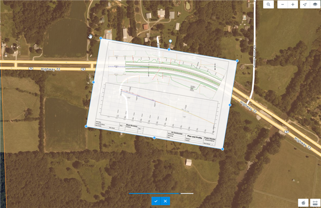

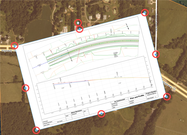

  1. If the PDF is not spatially located, it can be manually moved by left clicking on the PDF and dragging to the correct location or selecting the blue and white dots to resized and rotate.

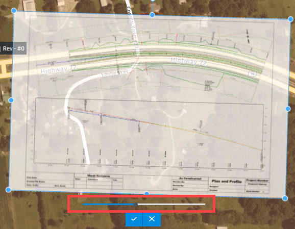

  2. The Opacity Slider located at the bottom of the window can be used to adjust the transparency of the PDF making it easier to manually locate to the correct location.

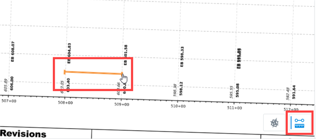

  4. The Calibrate Graphic Scale allows the PDF to be calibrated based off a known measurement on the PDF. After selecting the Calibrate Graphic Scale tool, select both points of the know measurement.
  5. Enter the known distance and the unit of measure. This will calibrate the PDF to the correct size

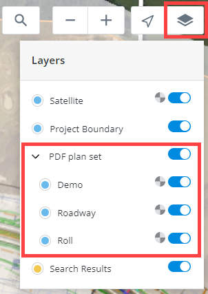

  7. Once the PDF is correctly located click the blue checkmark to Save. The PDF Plan Set Layer will now be visible on the map view.
  8. Once the PDF is Located on the map a Map Location icon will be added the PDF sheet.
