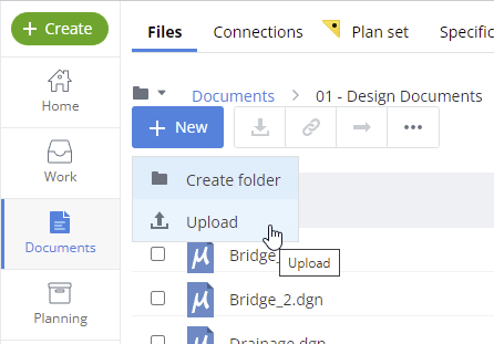

  1. Once the design file is downloaded it can be added to the SYNCHRO control documents by selecting New > Upload. Then navigate to the location of the downloaded design file.

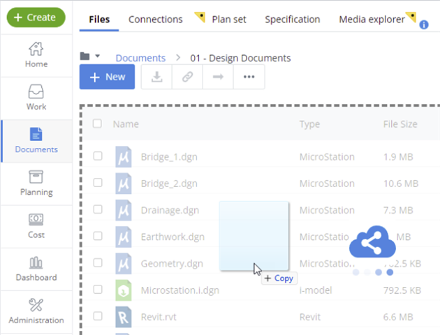

  2. Or drag and drop the updated design file to the SYNCHRO Control folder location.

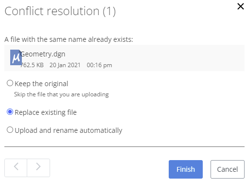

  3. This will pop up a Conflict Resolution Select Replace existing file and the updated file will replace the original file.

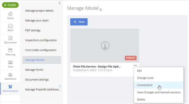

  4. The iModel can now be resynced to reflect the changes in the new design file. Go to Administration > Manage iModel. Then select the meatball menu option in the iModel container and select Connections.

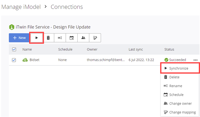

  5. Select the checkbox beside the required connection then select This will update the iModel with the changes from the revised design file.
