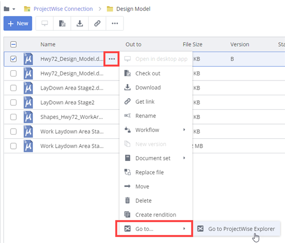

  1. To access and update the ProjectWise stored design file from SYNCHRO Control go to Documents > Connection. Then select the folder with the required design file.
  2. Now select the meatball menu beside the design file name, then choose Go to ProjectWise Explorer from the drop-down menu.

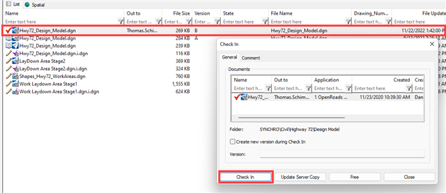

  3. In ProjectWise Explorer select the design file that requires updating. Once the necessary updates are made, close out and check the design file back in.

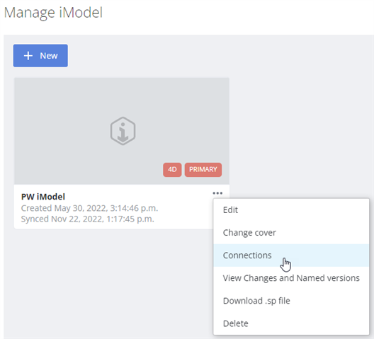

  4. Now that the design file has been updated in ProjectWise the changes can be synced to the existing iModel in SYNCHRO. Go to Administration > Manage iModel.
  5. Select the meatball menu option in the iModel container and select Connections.
  6. Select the checkbox beside the required connection then select This will update the iModel with the changes from the revised design file.
