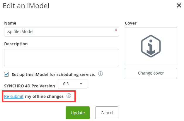

  1. If changes to a SYNCHRO project were made on an offline version and are required to be synced back to the control project. A .sp file can be saved and synced to the existing project in SYNCHRO Control. To do this select the meatball menu option in the iModel container, then select Edit.
  2. From the Edit an iModel window select the Re-submit my offline changes.
Note: This will submit local changes to scheduling services by uploading and .sp file. The existing schedule will be deleted from the scheduling service.

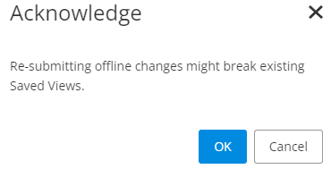

  1. An acknowledgment pop-up will inform you that re-submitting offline changes might break existing Saved views.

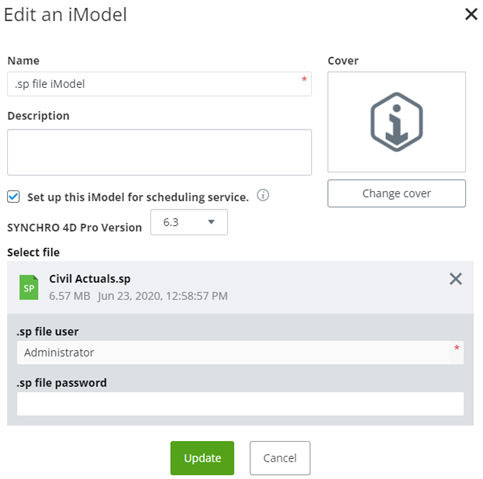

  2. Upload the new .sp and file, then select Update.
  3. This will synchronize the offline changes to the exist project in SYNCHRO Control.
