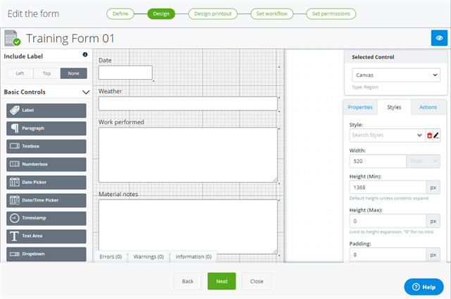

From the Form Design Page, we can start to design our custom form.
Design Form - Control Options
Controls

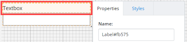

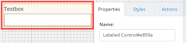

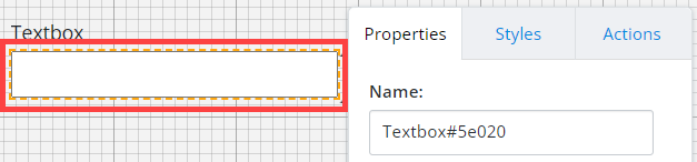

Controls are made up of three parts:
  1. Labeled Control (Full Control = Actual Control and Label)
  2. Control (Actual Control)
  3. Label
Note: This will be important to know for the Bindings and Actions sections

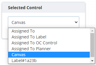

Selected Control
Selected Control identifies what control has been selected, and its type. It also allows you to switch between all active controls assigned to the form.
Note: The Selected Control box can be placed anywhere on the screen for ease of access.

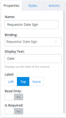

Properties
From the control panel on the right, you can set the properties for the control in the Properties tab. Properties differ for each control. The following are the common control properties:
Styles

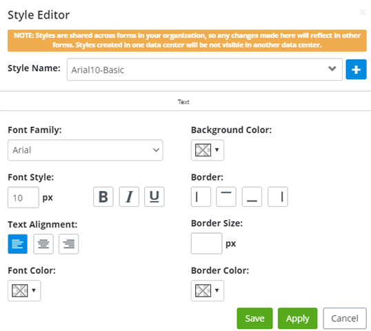

The Style tab of the Form Settings dialog lets you edit the dimensions, padding, and spacing of the form. You can also select preset styles for the controls.
Style Editor

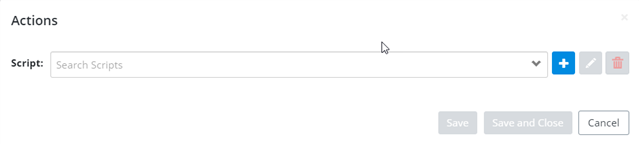

Actions
Actions has moved in the top toolbar and can be used to manage your scripts for the entire form.
Actions
allow you to perform operations using the data entered in controls. Before you can use actions, you must first understand Bindings. In Forms Designer, click the Forms Settings button from the top panel. From the dropdown list you can choose from available Actions. You can delete an Action by selecting the Action and clicking the Delete   icon. You can edit an Action by selecting the Action and clicking the Edit    icon, which opens the Actions dialog box described below.

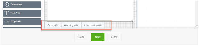

Error, Warnings, and Information
Form Errors, Warnings and Information are listed at the bottom. They identify issues within the Forms formatting.

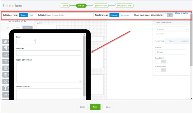

Form Preview
Form Preview allows you to view and test out the form on a mobile device view, to ensure formatting and functionality are correct.
  1. Click the Preview button  at top right of the top panel.
    The bar across the top provides the following options:

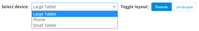

    • Select Preview: View from a mobile device or web browser.
    • Select Device: Switch between Device sizes.
    • Toggle Layout: Switch between Portrait or Landscape.
    • Show in design dimension: Allow design dimensions to be Toggled (On / Off).
  1. Select whether you want to preview the form on a Device or on the Web.
    • If you select Device, you can select the general size of device (Large Tablet, Small Tablet, Phone) and the layout (Portrait or Landscape).
    • If you select Web, you can test how the form will look on different screens by changing the Width and Height.
  1. Choose Devicefrom the Select preview option to see how your form will appear on a device. From the Select device list, you can select Large Tablet, Small Tablet, or Phone to see how your form will appear on each device. Select Portrait or Landscape from the Toggle layout option to show the preview device in portrait or landscape layout.
