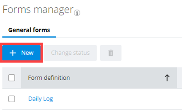

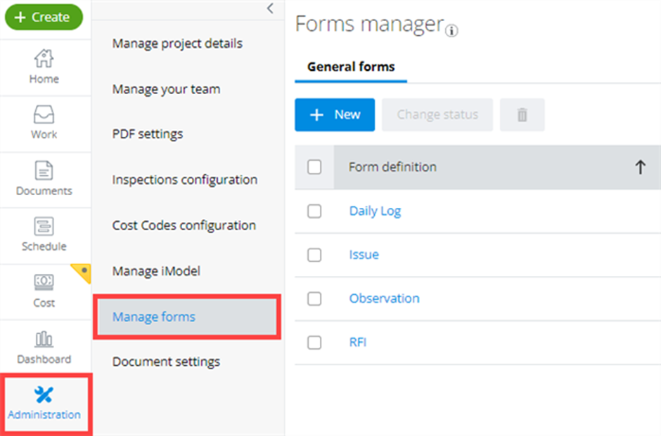

- Go to Administrator > Manage Forms. From here the template Forms that come with SYNCHRO Control can be accessed.
Note: If the Manage Form option is not visible in the Administration settings, you will need to contact your project Admin to grant you access.

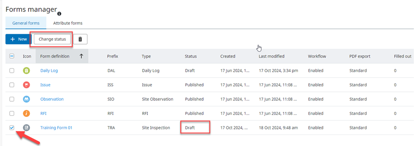

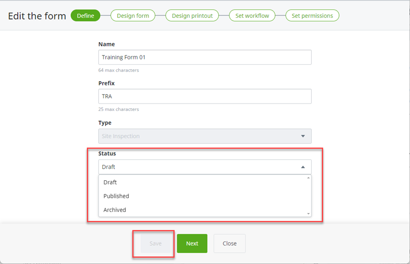

- To Edit a Form, change the Status to Draft by clicking on Change Status button.
- To create a new Form, click New.

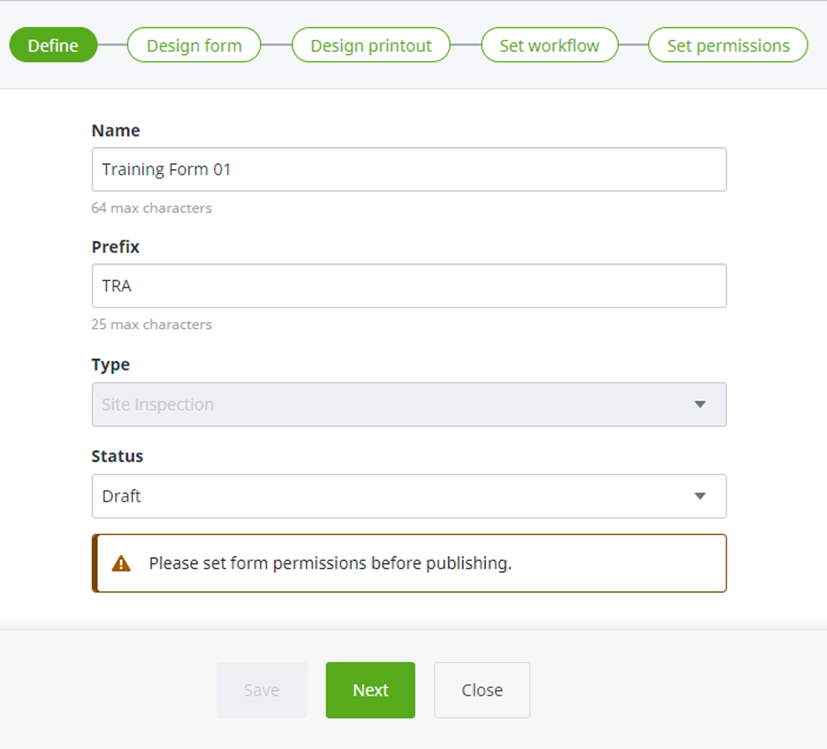

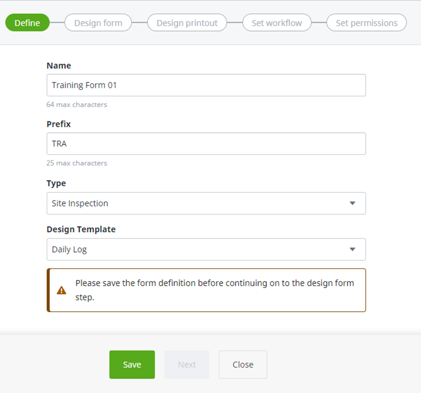

- The Define section will display and require you to enter the following information:
- Name is the Title of the form which has a max of 65 characters.
Note: The Name can be made longer than 65 characters in the Design section.
- Prefix is used to generate a unique identifiers for each form definition and are used as part of the ID when creating form instances.
Note: A max of 25 characters are allowed.
- Type has 24 out of the box form types that can be used for custom forms. You can also create new custom types. The Form Types are as listed below:

- Design Template allows users to use an existing Form Template to build their custom form. The new form category will follow the design template that we use.

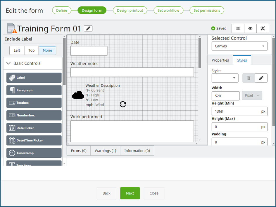

- Once all the fields are populated click Save. This will create a Draft version of the form. Click Next to bring you to the Design Form page.
- The Form designer interface displays where you can define the Form.
There is a Preview button
at top right, to check the form view.

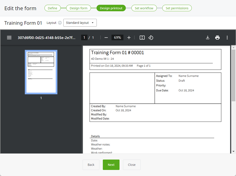

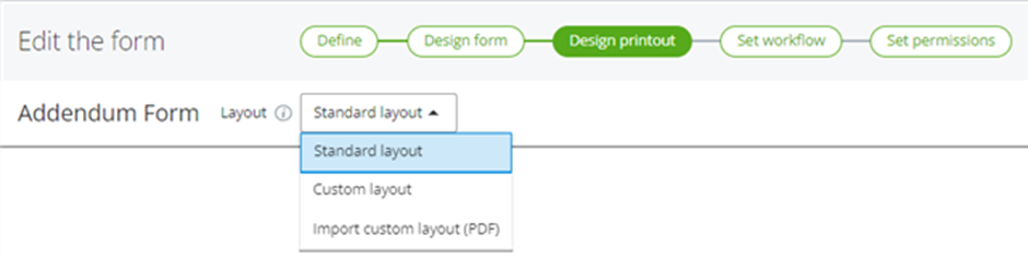

- The Design Printout tab provides options for setting the report output.

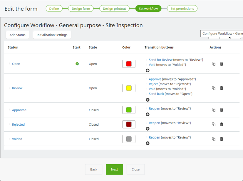

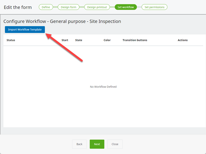

- Click Next to set the Workflow.

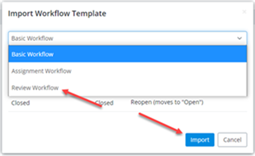

Since it does not have a workflow defined yet, click Import Workflow Template to import an existing workflow.
Example, we select the Review Workflow option and click the Import button.

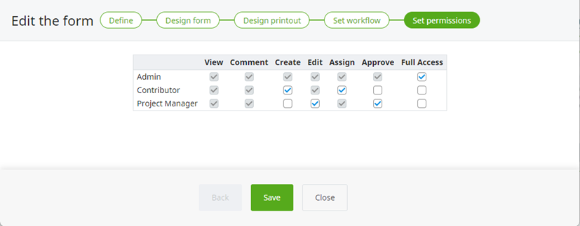

The Review Workflow is loaded into the form. Click Next to Set Permissions.
- Set the Permissions as needed and click Save.
- When finished assigning permissions click Close.

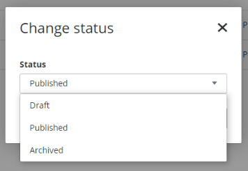

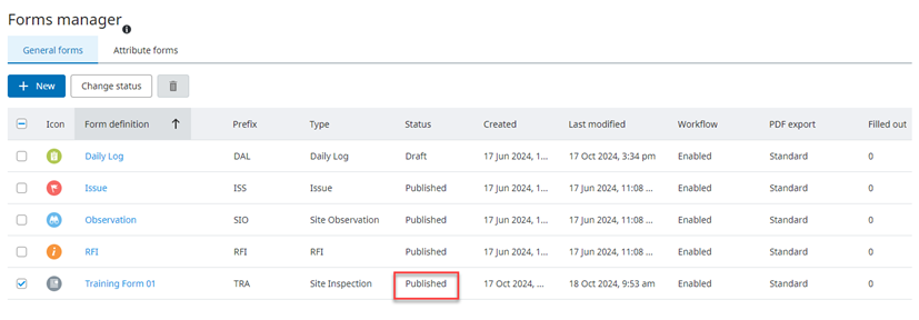

- In the Forms Manager, select the Training Form then click the Change Status button.
- Select the Published option and click Save.
Or, also can change the form status at the Form Details view

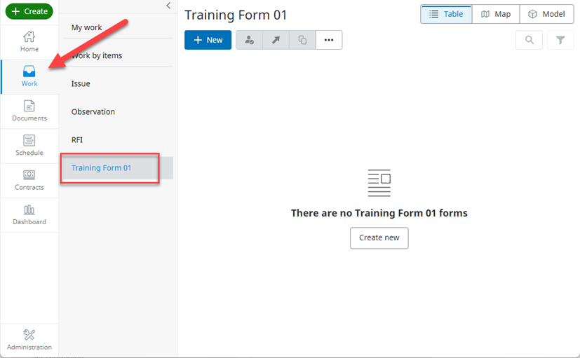

The Published form now displays under the Work module.
