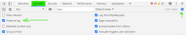

Console log (.log file)
  1. Select the Console Tab, and check "Preserve log". If it is not visible, click on the cog and then the "Preserve log" option should appear.
  2. Navigate to your SYNCHRO Control Project in the same Tab. (Do not close Developer Tools)

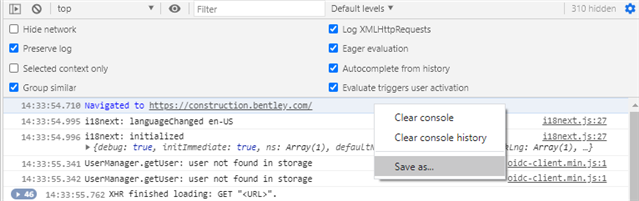

  3. Perform the actions that lead to the error being shown in the SYNCHRO Control Project.
  4. Once the error has shown, download the Logs by right-clicking in Developer Tools, and selecting "Save as..."
  5. Save the file to your machine.

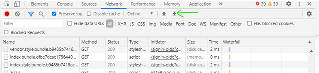

Network log (.har file)
  1. To download the Network Log click on the "Network" Tab and click on the downward arrow button as seen below.
Now you have can attach both the .log and .har files to your Support Request (or its response).
