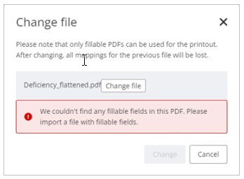

Q: How do I know if my PDF is supported?
A: The quickest way to know if it is supported is to upload it to SYNCHRO and see if the fields are detected. If the file is not supported, an error message will appear.

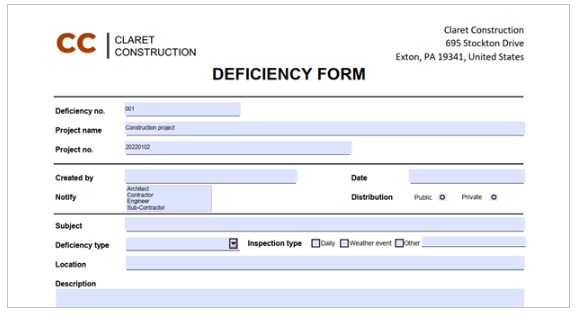

If you want to determine whether your PDF is supported, you first must determine if it is fillable at all.
To check whether the PDF is fillable, open the PDF in a viewer and look for fields that allow data entry. See example of a fillable PDF below:

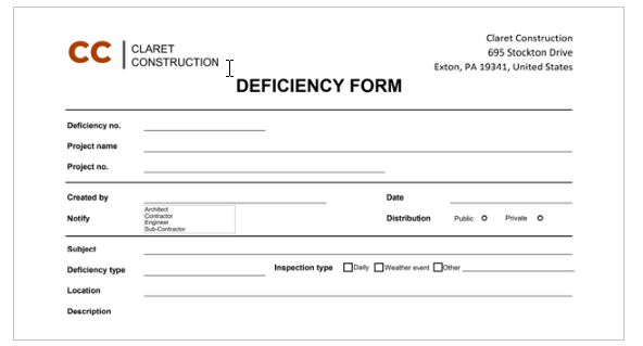

Compared to a PDF that is flattened (not fillable):
If the PDF file does not have fillable fields, it will not be supported for upload by SYNCHRO.
Note:  Scanned forms, as well as PDFs created from Word or Excel are generally flattened unless fields are specifically added to them after they are converted to PDF.

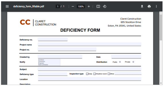

If you have determined that your PDF does have fields and you want to further check if it is supported, the quickest way to check if it is an AcroForm (supported) or XFA (not supported) is to right click the file and choose to open it in a web browser.
If the file is a fillable AcroForm, the contents of the form will be displayed:

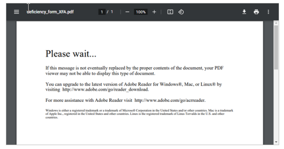

If the file is a fillable XFA/LiveCycle form, a warning will be displayed:
If the error message shows up in the web browser, the PDF will not be supported by SYNCHRO.
