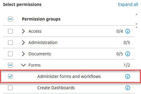

Access
When enabled, the Import from CSV option is only available to users who have the Administer forms and workflows permission assigned. It is recommended that this only be available for administrators of the project.

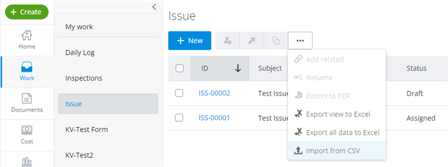

- Go to a forms grid and click the more
icon.

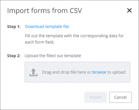

- Select Import from CSV from the drop down to display the following dialog:

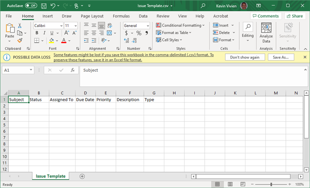

- Download the template file and open it.
The template file columns are taken from the fields in the form type. (Issue, Daily Log etc.)

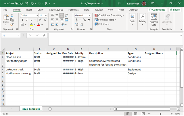

- Fill in the data for the fields identified and save the file. Some examples are in the file below.

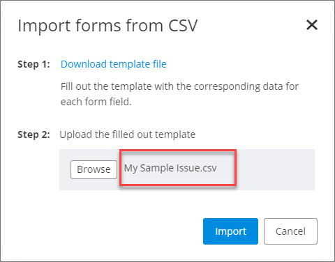

Remember: Required fields must include data to be able to import the file. - Once the file has been saved drag the file into the Import dialog:

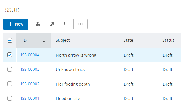

- Select Import to complete the process. The new form will display in the grid.
The form can be edited using the normal form editor as well as progressed through the workflow defined for the form type.
Sample Template File
The sample issue template file below can be used to view how data fields are populated. If working in a test project, this file could be used with the above procedure to view the import outcome.
