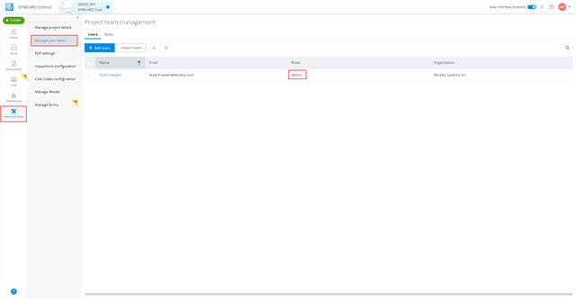

To provide user access to the SYNCHRO Cost module, you must assign them a Role with specific permissions enabled. You can do so by going to Administration > Manage your teams > Users

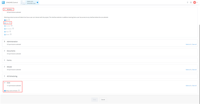

The Role should have the following Permissions enabled -
Access > Cost
Cost > Setup Cost Contracts
Required to create new Contracts
