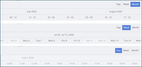

  5. Timescale: Adjust the date scale for a precise view. Choose between Day, Week, or Month options at the screen's top right. Alternatively, hold the Ctrl key and scroll the mouse wheel for finer adjustments.

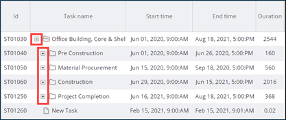

Schedule WBS can be collapsed or expanded by selecting the + and – boxes.

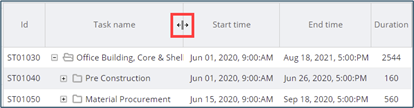

Task Columns can be resized by simply hovering the mouse between columns and dragging to the desired size.

The date scale can be adjusted by using the Day, Week, or Year options on the top right of the screen, or holding the CTRL key and scrolling the wheel on your mouse back and forth to zoom in or out.

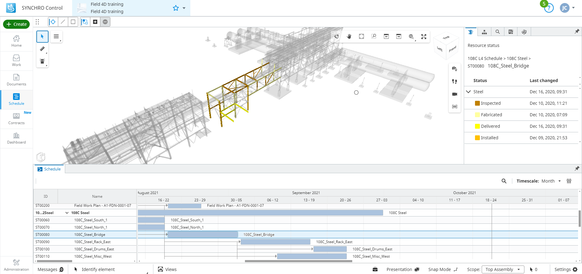

Status View allows you to choose a task and observe any assigned resource statuses for that task. This provides a visually appealing way to use color coding for tracking progress or any other status you wish to monitor on the model.

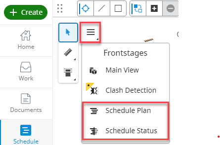

To switch to the Schedule Status view, use the Frontstage button and choose Schedule Status. You will now view the model in Status colors and playback with Status dates (and time).

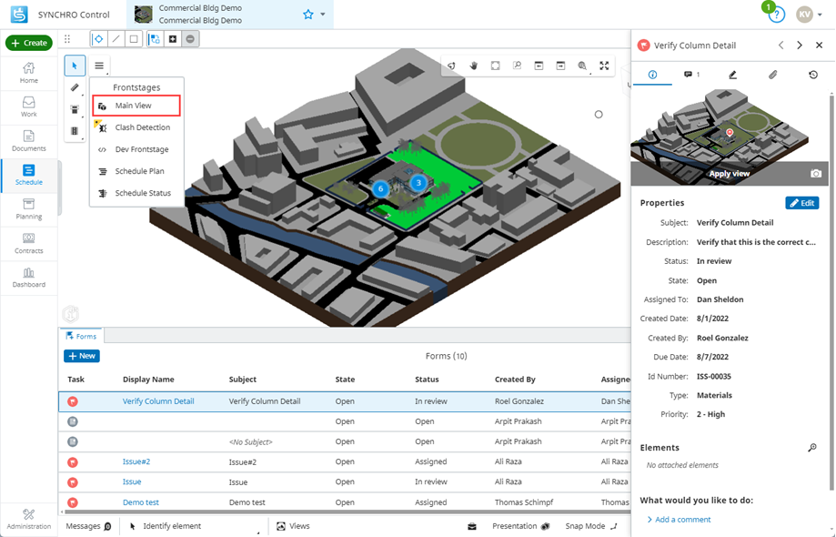

Create/Edit Forms in Schedule view
The Main View displays the Forms grid allowing you to create, edit and view forms associated with the Model.
