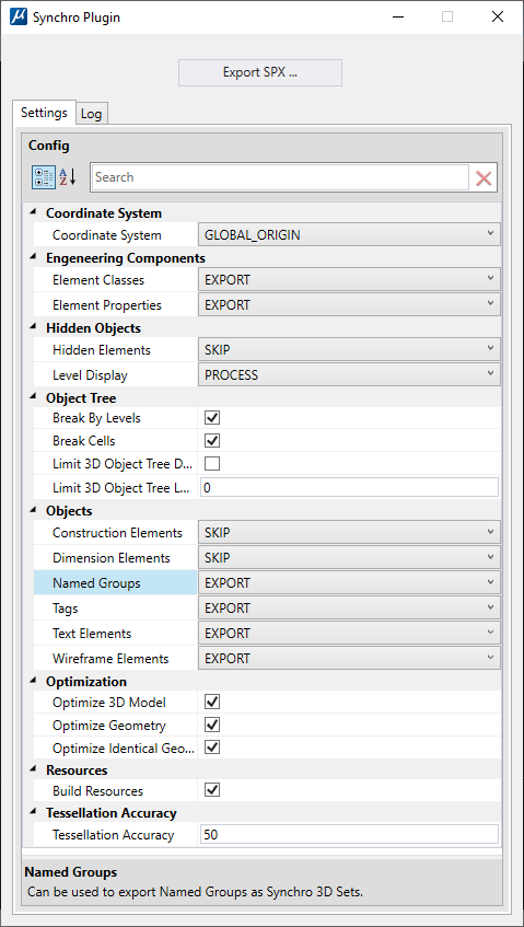

  4. Choose Settings as desired
    Coordinate System
    - Can be used to export in world coordinate system or in local \"Global Origin\" coordinates system.
    Engineering Components
    Element Properties - Can be used to skip the export of Engineering Component properties as SYNCHRO User Fields.
    Element Classes - Can be used to export of Engineering Component classes as SYNCHRO 3D Sets.
    Hidden Objects
    Hidden Elements - Can be used to export hidden elements.
    Level Display - Can be used to skip levels that are not added to Level Display in selected 3D view.
    Object Tree
    Break By Levels - When enabled, 3D elements are grouped by levels.
    Break Cells - When enabled, creates separate node for each 3D element under leaf cell.
    Limit 3D Object Tree Depth - Enable to limit the maximum depth of 3d object tree.
    Limit 3D Object Tree Levels By - This option determines the maximum depth of 3d object tree.
    Objects
    Construction Elements - Can be used to skip the export of construction elements.
    Dimension Elements - Can be used to skip the export of dimension elements.
    Named Groups - Can be used to export Named Groups as Synchro 3D Sets
    Tags - Can be used to export Tags as Synchro User Fields.
    Text Elements - Can be used to skip the export of text objects.
    Wireframe Elements - Can be used to skip the export of polylines, lines, circular arcs, circular arcs, circles, elliptical arcs, ellipses, nurbs curves objects.
    Optimization
    Optimize 3D Model - Enable optimization of 3D model on export.
    Optimize Geometry - Enable optimization of geometric objects.
    Optimize Identical Geometry - Enable optimization of identical 3D objects
    Build Resources
    - Create resources by 3D entity tree on export
    Tessellation Accuracy
    - Tessellation accuracy ( 0 - 100 ).

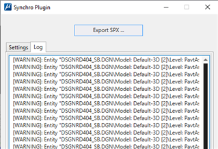

  5. Press Export SPX button
  6. Choose file location
  7. Dialog will be raised when export is finished
  8. Log panel will be populated with any messages
