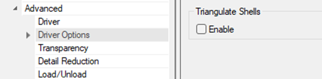

- Improved 3D scene responsiveness by adding geometry conversion. This new Triangulate Shells option, when enabled, works around the issue where 3D View might seem slower during camera interactions. This leads to slightly enhanced 3D scene responsiveness and reduced delays during camera interactions.

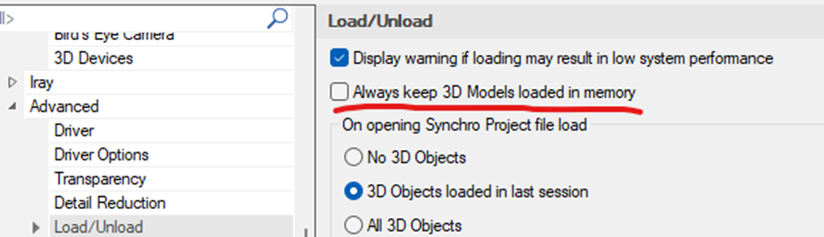

- Improved loading/unloading models on large projects with new option - When the option is enabled, all 3D objects are loaded into memory at project open and remain loaded; loading/unloading in the 3D Objects tree only controls visibility like 3D filters. It is best for workflows where frequent toggling, navigation, or interaction with many objects is expected throughout the session. But it also may result in slower project opening initially, higher memory usage, and a trade-off with not as fast or smooth overall performance.
