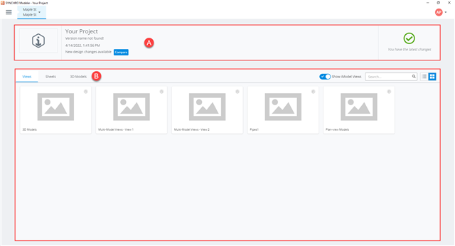

The iModel Index page provides various details and options relating to the selected iModel.
A.    Project Details
Provides the following information regarding the iModel –
B.    iModel Views
The iModel can be opened by one of the following methods, which opens the Default View.
Views tab are either autogenerated from different views available in the model authoring tool or manually created in SYNCHRO Control or Modeler.
Sheets
tab are autogenerated from different sheets available in the model authoring tool.

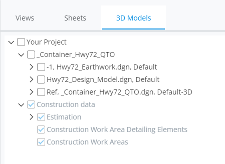

3D Models tab provides the option to select specific models or elements from the model hierarchy in the visibility tree.
Show iModel Views option toggles the visibility of autogenerated Views.
Search Bar
can be used to find specific Views or Sheets.
