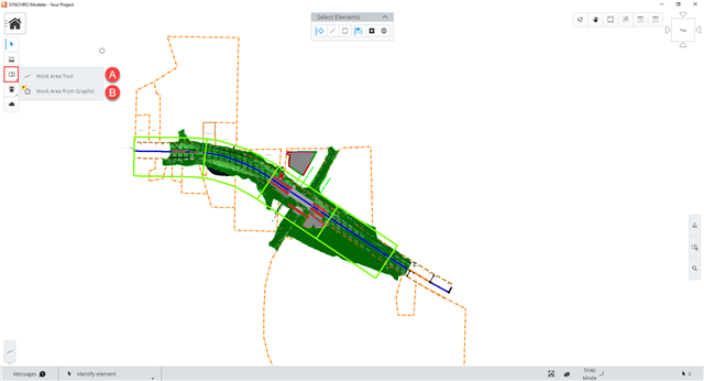

This module opens the front-stage view that has additional tools for creating Work areas. This can be done using Alignments or Graphic. The following rules are considered –
The Work areas are saved in the local cache and need to be synced to the cloud by clicking on the cloud   icon.  After sync, sliced elements from SYNCHRO Modeler are visible in SYNCHRO 4D Pro, as a child element of the original parent hierarchy.
Currently, only the Work area boundary is visible in SYNCHRO 4D Pro under Construction Data tree. No Work area property is exposed for associated elements.
A. Work Area Tool (from Alignments)
B. Work Area from Graphic
