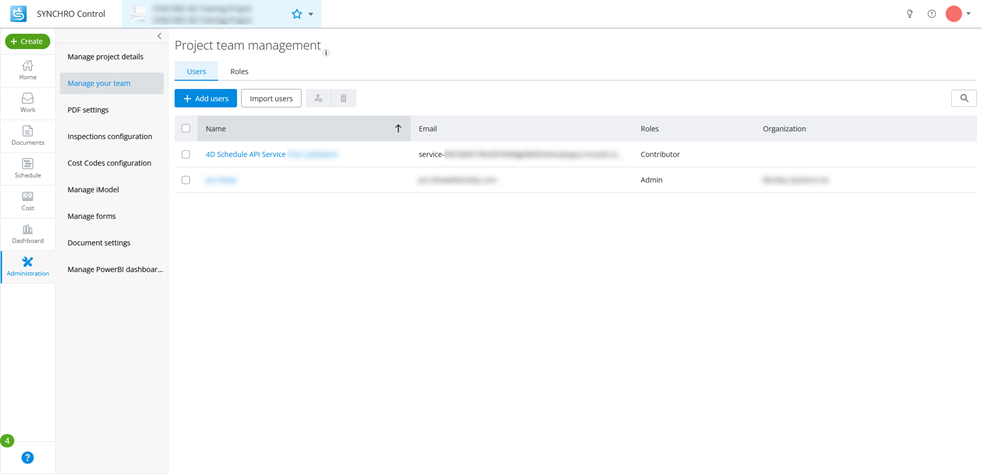

The service app type does not represent any user or organization and does not have access to anything by default. If you want to provide access to projects for that application, you need to invite it to the projects using client email, provided in App details page.
To connect to a SYNCHRO 4D project schedule the service application client email must be added to the project in SYNCHRO Control: https://construction.bentley.com:
Select the SYNCHRO 4D project > Administration > Manage your team > Add users > Add user provided from Service app
The Service app user must be provided with a Role that has the appropriate read/write permissions for the commands you would like it to perform.
