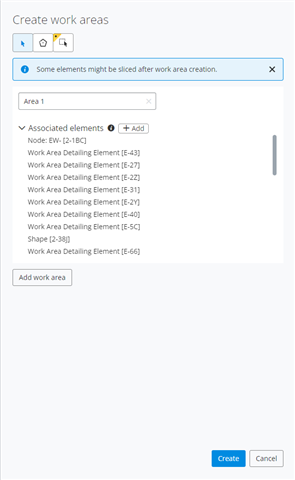

Work Area from Graphic
This widget associates selected element(s) to Work areas.
Select elements
Draw polygon
Get polygon from element geometry
The selection can be done using the following tools -
Select element(s) associates manually selected element(s) to the Work area.
Draw polygon
creates a custom closed polygon by snapping to elements in the model and associates all elements within its boundary to the Work area. The polygon is displayed at zero project level and may be much further below the geolocated model’s extent.
Note: For non-geolocated models, the polygon may not be able to snap to any of the model elements or the boundary is not visible. Reach out to SYNCHRO Support for assistance.
Video -
communities.bentley.com/.../Wa_2D00_polygon_2D00_Jun6.mp4
Get polygon from element geometry uses any existing 2d design shape and associates all elements within its boundary to the Work area.
Video -
communities.bentley.com/.../WA_2D00_from_2D00_graphics.mp4

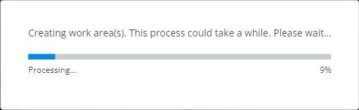

Once the element(s) are selected, add them to the Work area by clicking on  , enter the Work area name, and click Create for processing.
Click on  icon towards the right edge of the elements to remove them from the Work area.
Click on Add work area to create multiple work areas in one go.
Depending on the size and complexity of the iModel, creating Work areas may take some time to process.

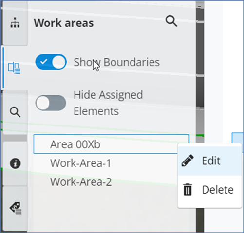

Edit and Delete Work Area
Work Area can be edited:
Work Area can be deleted by select Delete.
Note:
Right now, After Work Area create there is no Remove Component function.
