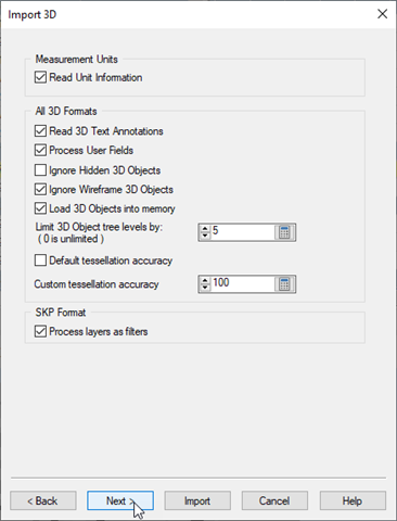

- Select Next to view the import settings. Ensure that your settings match those in the image below.
- Ignore Hidden 3D Objects: when enabled, objects that are hidden by filters or other display controls in the 3D file will not be imported into the SP file.
- Ignore Wireframe 3D Objects: when enabled, polylines, lines, circular arcs, circles, elliptical arcs, ellipses, and nurbs curves objects will not be imported into the SP file.
- Load 3D Objects into memory: controls whether imported objects are automatically loaded into If disabled, imported objects will not be loaded into memory and will not be visible in the 3D window. Disabling this option tends to reduce the time to import and is recommended especially for large files.
Note: To load/unload an object from memory after importing, check the box next to the object name in the 3D Objects tab.
- Limit 3D Object tree levels by: This option determines the depth of the 3D file.
Note: This feature is especially suitable for models containing multiple hierarchies, all of which are not required to map the 3D geometry to 3D resources.

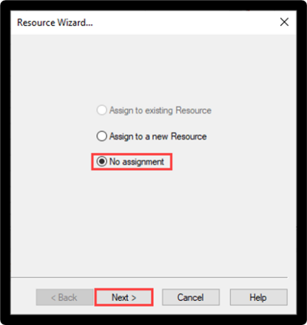

- When the import is finished the Resource Wizard will appear, choose No Assignment. We will cover the topic of Resources and Resource Wizard in the later practice sessions.
Note: Selecting “No assignment “will finish the 3D import process without creating any Resources.
These 3D objects would not be able to be assigned to Tasks until Resources were created. If you receive the warning shown below, it is likely because you chose No Assignment on import. You would then need to create Resources for the 3D objects by activating the Resource Wizard manually.
- Then click Finish.
