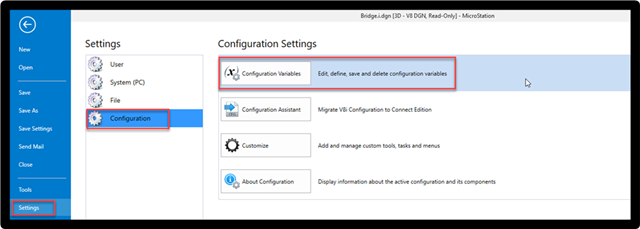

- Go to Files > Settings > Configuration > Configuration Variables.
- Find MS_DGNAPPS variable, press Edit.

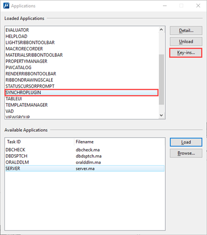

- Select Utilities > MDL Applications.
- In the MDL Applications dialog, highlight SYN_PLUGIN within Available Applications, then choose Load.
- Highlight SYN_PLUGIN within Loaded Applications, then choose Key-ins.

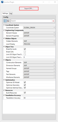

- You will be presented with the SYNCHRO Plugin window. There are several export options available: Coordinate System - Can be used to export in World coordinate system or in local Global Origin coordinates The Global Origin can be queried by typing “go=” command in MicroStation.
Note: MicroStation exports files in local Global Origin coordinate system (export to FBX, JT, etc.), but when you x-ref the file into another DGN, it appears in Global World coordinate system.
Element Properties - Can be used to skip the export of Engineering Component properties as SYNCHRO User Fields.
Element Classes - Can be used to export of Engineering Component classes as SYNCHRO 3D Sets.
Hidden Elements - Can be used to export hidden elements.
Level Display - Can be used to skip levels that are not added to Level Display in selected 3D view.
Break By Levels - When enabled, 3D elements are grouped by levels.
Break Cells - When enabled, creates separate node for each 3D element under leaf cell.
Limit 3D Object Tree Depth - Enable to limit the maximum depth of 3d object tree.
Limit 3D Object Tree Levels By - This option determines the maximum depth of 3d object tree.
Construction Elements - Can be used to skip the export of construction elements.
Dimension Elements - Can be used to skip the export of dimension elements.
Named Groups - Can be used to export Named Groups as SYNCHRO 3D Sets.
Tags - Can be used to export Tags as SYNCHRO User Fields.
Text Elements - Can be used to skip the export of text objects.
Wireframe Elements - Can be used to skip the export of polylines, lines, circular arcs, circular arcs, circles, elliptical arcs, ellipses, nurbs curves objects.
Optimize 3D Model - Enable optimization of 3D model on export.
Optimize Geometry - Enable optimization of geometric objects.
Optimize Identical Geometry - Enable optimization of identical 3D objects.
Build Resources - Create resources by 3D entity tree on export.
Tessellation Accuracy - Tessellation accuracy ( 0 - 100 ).
- Choose the settings that you prefer and click Export SPX.
