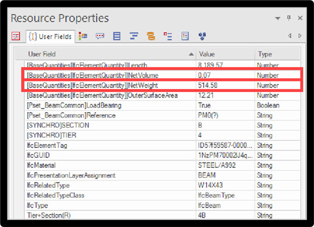

- Observe Resource User Fields for any selected 3D Resource;
For any selected 3DResource, you can find Resource User Fields “[BaseQuantities[IfcElementQuantity]]NetVolume” and “[BaseQuantities[IfcElementQuantity]]NetWeight”.

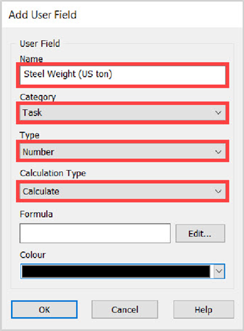

- Create Task User Fields “Steel weight (Ton)” and compute total steel needed per task each task;
Steps are similar as those for creating a text type user field. But this time you would use SUM() to get a the sum of all valid elements from the argument. For example, SUM(object.UFV("Volume")) returns the sum of the Volume of all objects and objects in Synchro can be Task, 3D and Resource.
So in our case, the formula will be as follows:
Note: Do NOT type allot, use Search box on top left corner instead, to look for the Resource User Field “….NetWeight” and to look for Syntax “SUM.”

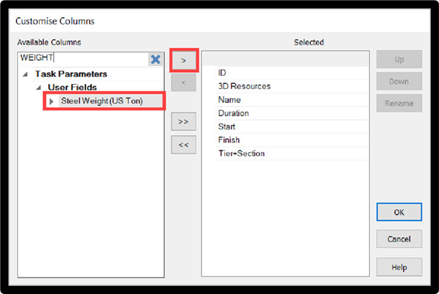

- Customize Columns to display the “Steel Weight (Ton)” User Field:
- Select all tasks > Check “Steel Weight (US Ton)” > Recalculate Values using the settings below:

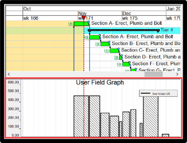

- For the Selected User Field “Steel Weight (Ton)”, check the box “Draw in UF Graph”;
- Then go to Project Controls ribbon then click User Field Graph icon, the graph will be plotted if the User Field type is Number or Integer:

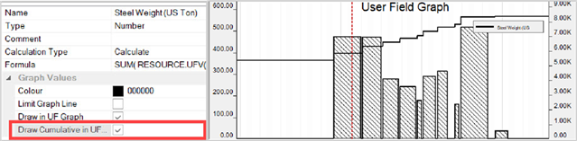

How can you show cumulative in UF graph or add a limit graph line?
- Cumulative UF Graph:
- Limit graph line:

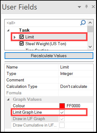

- Create a Task-Based User Field to represent your graph limit values, making sure the Limit Graph Line option is selected.
- Assign User Field Values manually by providing a specific value. This value will represent the limit line on the graph.
