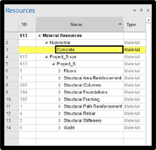

Under Resources, we have Material Type Resources – Concrete and Steel, which are not associated with 3D objects. In the next part, we will learn how to load the Resource quantities in Resource Properties tab.
Loading Resource Unit
- Create Material resource "Concrete". Select “Concrete” resource > Select tasks related to concrete> Assign Resources;

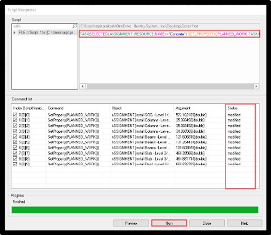

- Create a TXT file > Save your script in it;
Script can be saved as a TXT file and then opened to be run later.
TASK(SELECTED).ASSIGNMENT (RESOURCE.NAME=="Concrete") SET_PROPERTY( PLANNED_WORK, TASK.UFV("Total Volume") )
This script assigns the UFV “Total Volume” to the planned units of resources assigned to the selected tasks. Here are some explanations:
The basic format of one line of script is <Object> (Condition) <Command>.
In this script:
- Object:
TASK (SELECTED) - all selected tasks in the project;
- ASSIGNMENT - When applied to a Task, returns all the assigned Resources with access to the assignment properties;
PLANNED_WORK - planned units of resources;
- Command:
SET_PROPERTY( PLANNED_WORK, TASK.UFV("Total Volume") ) - Changes all planned units with Total Volume user field value.
- “Project Control” Ribbon > Synchro Script > Right-Click > Add External Script to open the script file;
- Preview to Check > Run;

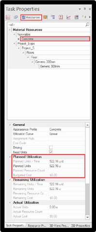

When we go back to the Tasks Properties we can choose one certain task to check if the resource units have been modified.

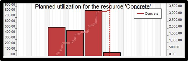

Resource Usage Graph
- Go to Windows > Resource Usage Graph to open it.
- Unselect other resources and only select Concrete resource.
- Right-click on Resource Usage Graph:
- Tasks > All Tasks
- Resources > Selected Resource(s) > check Material Resources
- Options
- Data > Stack Resources, Planned Utilization
- Histogram > Units/Time, week
- Curves > Units (cumulative)
