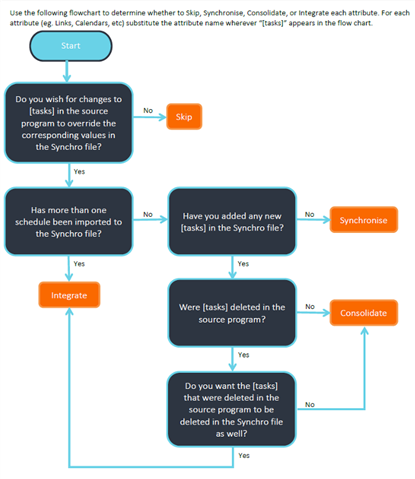

Synchronization Options
- Skip
- Synchronize
- Updated schedule / model will complete replace what is in Synchro
- Integrate
- Updated schedule / model will only replace those came from the old schedule / model, i.e., content created in Synchro will be kept
- Consolidate
If the task/3D object is imported from the old schedule / model into Synchro, but later it is deleted in updated schedule / model, it will be kept and will not be deleted in the 4D model in Synchro.
