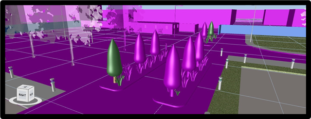

Selecting one or multiple 3D Object(s)

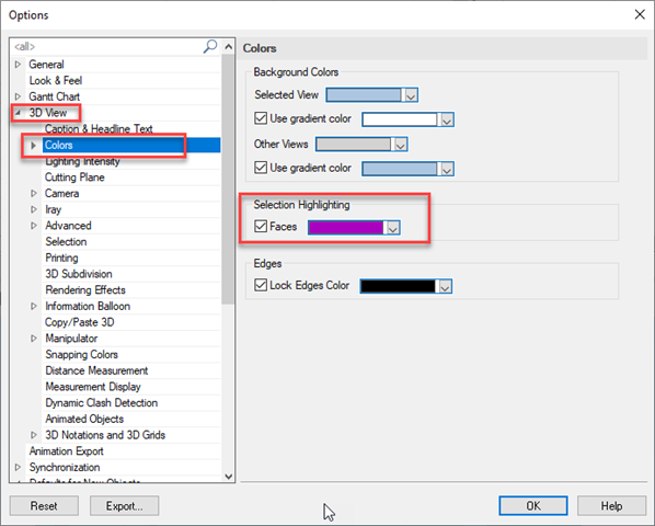

This section explains the various methods to select a single (or multiple) 3D object(s). When you select a 3D object, it will be highlighted purple in the 3D window (or designated selection color as defined in Options, choose 3D View > Colors, Selection Highlighting).

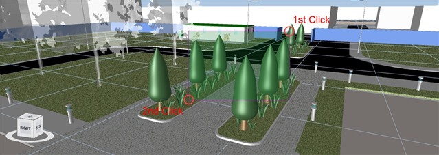

- Left Click in 3D View.
- To select one single 3D object, single left-click an object in the 3D View window. Any object that you click twice will be deselected.

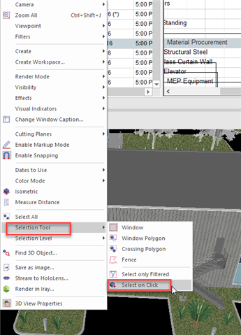

Note: If a single left click does not select an object, right-click in the 3D View window and enable Selection Tool > Select on Click mode.
- You can use ESC key on your keyboard to deselect all selected 3D objects.
- To select more than one 3D object, you can single left-click on the objects that you would like to select one by one in the 3D View window to select them one by one.

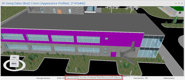

Note: Number of selected 3D objects will display at the bottom of the screen in the Status Bar.

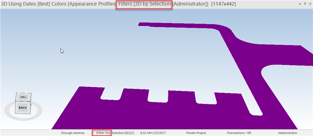

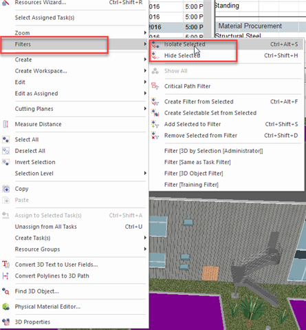

This section introduces the first type and the most commonly used (3D) Filter in 3D View window. You can use the 3D by Selection Filter to Isolate Selected or Hide Selected.
- Apply 3D by Selection Filter in 3D ribbon.
While there are 3D objects selected, the 3D by Selection filter can be enabled when using the 3D ribbon > Filters > Isolate Selected or Hide Selected button. There is one Selection filter per User.|
- Apply 3D by Selection Filter in 3D View window.
Also, while there are 3D objects selected, the 3D by Selection filter can be enabled when right-clicking in 3D View window, then click Filters > Isolate Selected or Hide Selected.
Hint: You can also apply 3D by Selection Filter using keyboard shortcuts. Hold down CTRL+ALT+S will enable Isolate Selected filter and hold down CTRL+SHIFT+H will enable Hide Selected filter.

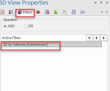

When there is 3D filter(s) applied, you will see the following indicators:
- 3D View window name will be updated with Filters [3D by Selection [User]] in the end.
- Status Bar will display [Filter On] in red.
- You will find the 3D by Selection filter listed under Active Filters in 3D View Properties window, Filters tab.
- Show all or deactivate all applied 3D Filter(s).
To deactivate all applied 3D Filters, you can click the Show All button in 3D ribbon, or right-click in 3D View, choose Filters > Show All. Also, you can clear the activated filter in the 3D Filters tab in the 3D View Properties window.

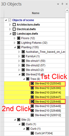

- 3D Objects window presents the 3D model(s) in a tree structure that reflects the hierarchy of 3D elements. Different model authoring programs may have different ways of organizing and grouping 3D objects. 3D Objects window reflects the 3D model in a tree structure manner, while the 3D View window presents the same 3D model with geometric shape.
- We will have the following findings in the 3D Objects window:
- Single Left click allows us to select a single 3D object or all 3D objects if the node is selected.
- Hold down CTRL and multiple left clicks allows to select multiple 3D objects.
- Hold down SHIFT, then left click to select the 1st 3D objects and the last 3D objects in the list. This allows you to select all 3D objects from the 1st selected and the last selected ones.
- To load or unload 3D in 3D Objects window, you can mark or unmark the box in front of the 3D object. You will see the 3D object to load and unload in the 3D View window.
- To apply 3D by Selection filter directly from 3D Objects window, when there are selected 3D objects, right click in 3D Objects window, then click Filters > Isolate Selected or Hide Selected. Show All is available to turn off all applied 3D Filters.
- To Collapse / Expand the node, similar to what we learned how this is done in the Task List, click on the
icon left to any node to collapse the 3D objects to that level. When collapsed, click on the
icon to expand the summary task.
Hint: 3D Objects window is also a table, try use SHIFT and Left Arrow keys together to collapse. Similarly, use SHIFT and Right Arrow keys together to expand the branch.
- We will also understand the following for the 3D Objects window and the 3D View window:
- Selecting 3D objects in 3D View window will also highlight these 3D objects in 3D Objects window.
- Selecting 3D objects in 3D Objects window will also highlight these 3D objects in 3D View allows us to select a single 3D object or all 3D objects if the node is selected.
- Loading or unloading 3D objects in one of the two windows will be reflected in the other window.
