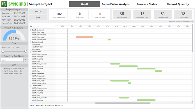

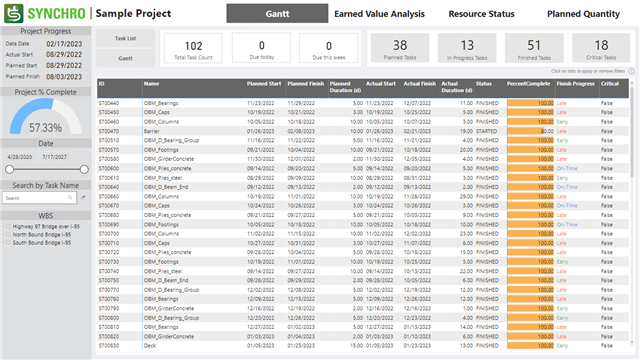

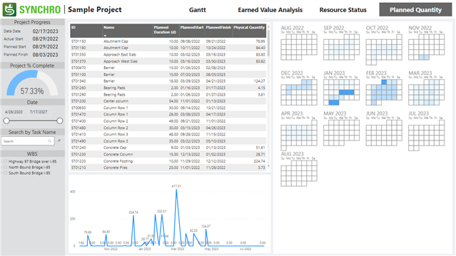

The template includes the following reports -
Gantt
EVA
Resource Status
Planned Quantity
Prerequisites

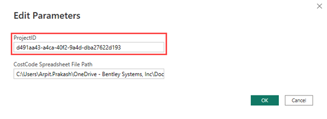

- Follow the instructions to set up a 4D Control project and install Power BI, as provided here.
- To open the Control project with the template, go to Home ribbon > Transform Data dropdown > Edit parameter > ProjectID - Enter SYNCHRO Control project URL -
Note: CostCode option is currently unavailable.

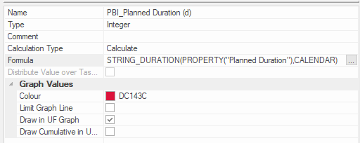

- Run the following User Field Formula to calculate Planned Duration -
STRING_DURATION(PROPERTY("Planned Duration"),CALENDAR)

Customizing the Template
Update WBS visual
To update the WBS hierarchy levels, select the visual and drag-drop additional levels from under TaskWBSHierarchy table to Visualizations pane > Fields -

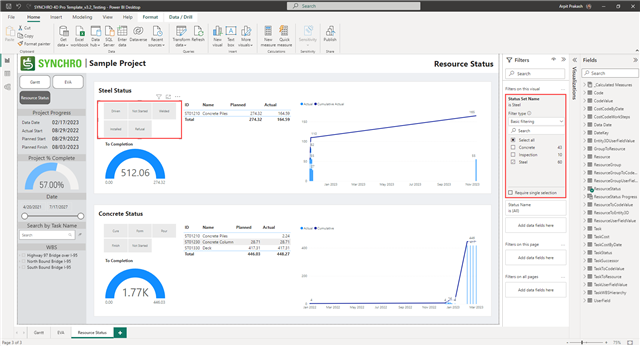

Update Resource Status categories
To update Resource Status categories, select the visual and select the required Status Set Name from under the Filters pane -

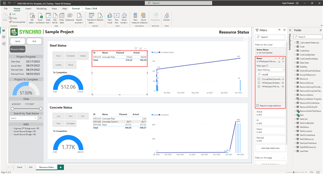

Then search for the User Field Name to track corresponding physical quantity from under the Filters pane -
Note: All visuals within the section would require customizations, wherever applicable.
