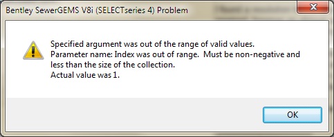

When opening a model, the following error message occurs:
"Specified argument was out of the range of valid values. Parameter name: Index was out of range. Must be non-negative and less than the size of the collection. Actual value was 1."
