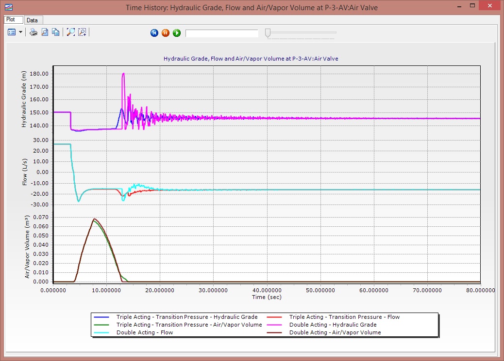

If you have multiple scenarios where you have different protection setup, such as different devices or different setups for a single protection device, it is possible to view Time History and Extended Node Data results for more than one scenario on a single graph. This applies to HAMMER V8i SELECTseries 3 (08.11.03.XX) and higher.

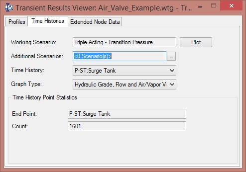

To do this, make sure you have computed all scenarios that you want to graph and then open the Transient Results Viewer. Choose the Time History tab (this works for Extended Node Data as well).

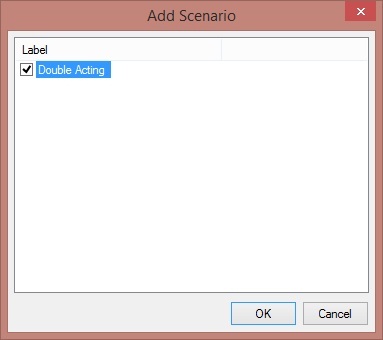

You will see an item called Additional Scenarios. Click the ellipsis button next to this and the dialog below will open:
This shows all additional scenarios that have been computed. The active scenario you are already will not be listed. Check the scenario or scenarios you want to view in addition to the active scenario and click OK. Now when you plot a graph, you will see results for both the active scenario and the other scenarios you selected.
Note that this option would only work if the report point you are graphing exists in all scenarios you are graphing.
