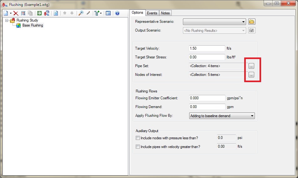

To resolve this, open the Flushing manager under Analysis > Flushing. Selected the flushing area that is affected and go to the Options tab. Then selected the ellipsis ("...") button next to the Pipe Set collection field.

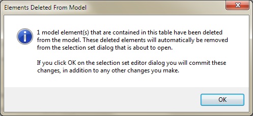

After selecting the ellipsis button, if there are pipes that are in the collection have are no longer in the model (that were deleted) , you will receive a message indicating this. Clicking Okay will remove the pipes.
If there are inactive elements in the list, you will need to locate and remove them. See note above about how inactive elements could have been included in the pipe set. To make things easier, consider clearing the selection, then re-selecting the elements with the "Display Inactive Topology" option (File > Options) checked, ensuring that inactive (typically defaulting to a gray color) are not selected.
After the deleted or inactive elements are removed, click the ellipsis button next to the Nodes of Interest collection and see if you get a similar message, stating that one node in the collection has been deleted. Clicking Okay will remove the node. Similar to Pipe Set, you may need to also review or re-select elements if there is a possibility that inactive elements are in the list.
When this is done, the collection for the Pipe Set and Nodes of Interest should be updated and accurate. Try rerunning the flushing analysis and the issue should no longer occur.

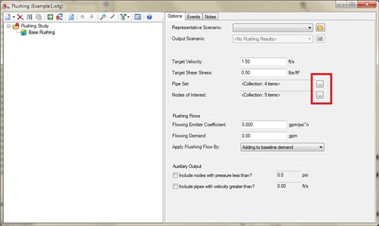

4) Open Flushing, click the Area/Zone in question, click the ellipsis button next to the pipe set
5) Click the select in drawing button, then click the green check mark > OK. The number of elements should now reflect the actual number (no longer including the deleted elements).
