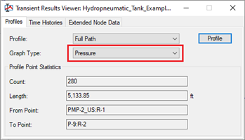

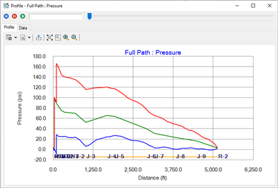

Solution - pressure profile
If you are using the same pipe material with the same pressure rating throughout your model, you could take a look at the pressure profile (choose the pressure option in the profile tab of the Transient Results Viewer) to see if the pressure exceeds the rating anywhere over the length of profile.

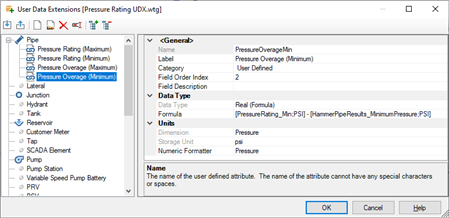

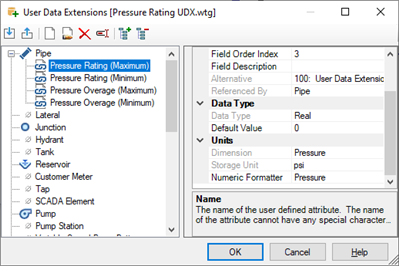

Otherwise, another option would be to use User Data Extensions with color coding or queries. First, create two new pipe user data extensions to store the minimum and maximum pressure rating value for your pipes.  Use the "Real" Data Type to set the pressure unit. Add them to the pipe flextable and filter (for example on material and diameter) as needed, then perform global edits to set the pressure ratings for all pipes.

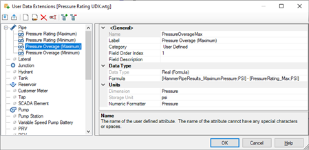

Next, create new formula-derived user data extensions that compare (via subtraction) the minimum/maximum transient pressure (from the transient results) to the pressure rating, to calculate the amount of pressure "overage" over the rating. Note that the "Pressure (Maximum, Transient)" and "Pressure (Minimum, Transient)" show the max/min pressure anywhere along the length of pipe during the transient simulation so it should account for more than just the pipe endpoints.
Formulas for Minimum and maximum pressure overage, where "PressureRating_Min" and "PressureRating_Max" are the names given to the user data extension you had created to store the pressure ratings:
Pressure Overage (Minimum): [PressureRating_Min;PSI] - [HammerPipeResults_MinimumPressure;PSI]
Pressure Overage (Maximum): [HammerPipeResults_MaximumPressure;PSI] - [PressureRating_Max;PSI]
