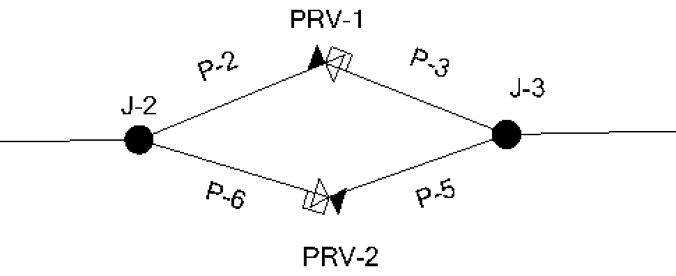

Modeling a "Two-way" PRV
To model a two way PRV where pressure is reduced in either direction, consider modeling two PRVs in parallel with the opposite orientation, like the following screenshot. The "Downstream pipe" properties of the PRV can be used to change the orientation. Depending on the flow direction, only one PRV will throttle at a time, because the other one will automatically close to prevent reverse flow.
