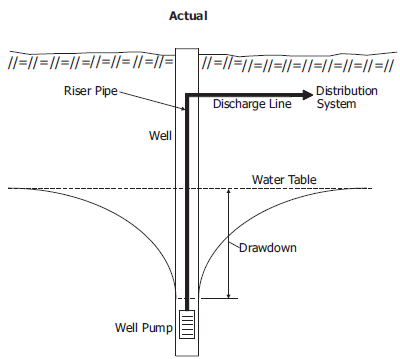

How can I account for drawdown effects of a well pump, for either a fixed speed or variable speed pump?

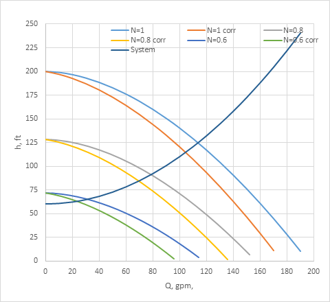

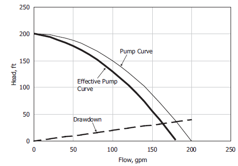

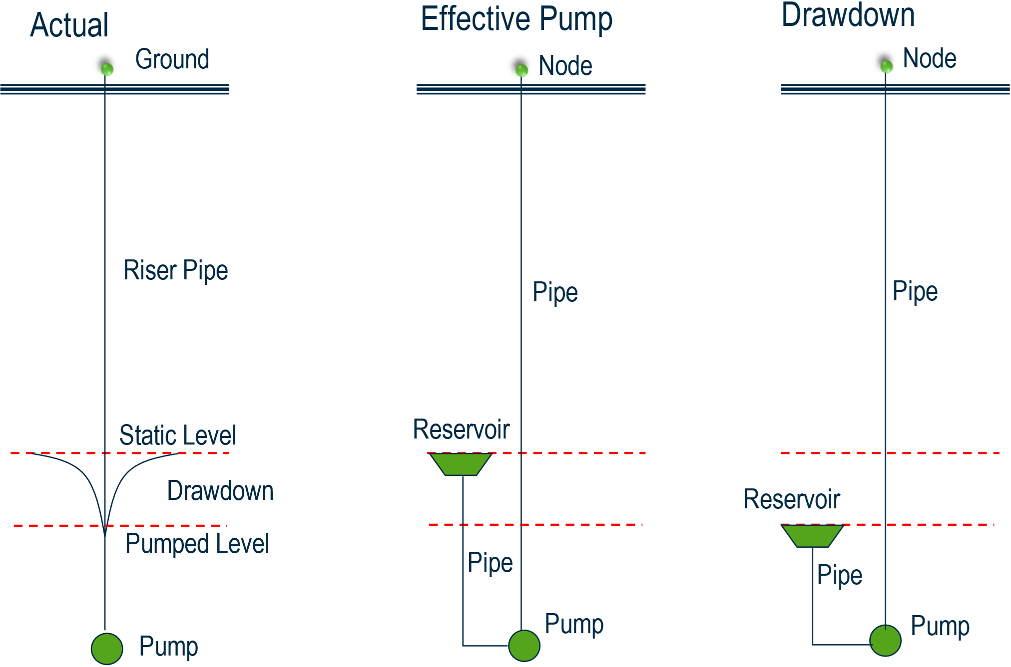

For a constant speed pump, well drawdown is normally accounted for by offseting the pump curve by the difference between the static and pumped groundwater elevations. The drawdown amount would be subtracted from the pump head values, and the new values would be used for the pump curve head data.

The first shows the way you can account for drawdown by modifying the pump curve. This generally works well for a constant speed pump. However it becomes quite difficult for a VSP because the speed is not known before the calculation.

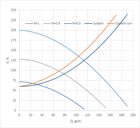

What really happens is that the drawdown can be approximated by reducing the suction head as a function of flow.  This solution looks like the graph below and is on the second sheet in the file.  The blue system head curve is no drawdown while the orange accounts for drawdown.
Note that the results for flow are the same for both sheets. For example at N (speed) = 0.8, Q = 70. However, the pump heads are off for the pump curve adjustment approach because the pump head curve was adjusted. This implies that it is better to adjust the system head curve than the pump head curve. But the program can’t do that directly without iterating. So, we need to insert something to cause head loss as a function of flow. This can be done with a General Purpose Valve (GPV) that gives the same head loss as the pump drawdown rate (0.2 ft/gpm).

In conclusion, the best way to model drawdown in a well (even for variable speed pumping) is to approximate the drawdown rate (e.g. 0.2 ft/gpm) with a GPV that has a curve with the points that correspond to the drawdown (e.g. (0,0) and (100,200)).
