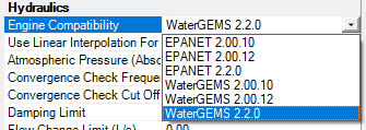

Should the EPANET solver and the WaterGEMS solver produce the same results for a model? Which solver is more accurate?
WaterGEMS and WaterCAD’s default numerical solver has many improvements above and beyond the core EPANET solver used to calculate hydraulics. Therefore, small differences in results are expected when comparing WaterGEMS or WaterCAD results to results in the EPANET program. To assist in cases where a user may want to solve hydraulics without these improvements, the “Engine Compatibility” calculation option can be used. For example, if you’re comparing results from the 2.00.12 version of the EPANET program, you would select EPANET 2.00.12 in the Engine Compatibility from the dropdown for the engine compatibility option. This will allow WaterGEMS or WaterCAD to solve the hydraulics with the same solver used in the EPANET 2.00.12 program itself.
By default, the Engine Compatibility mode will be set to “WaterGEMS 2.00.12” for new projects, which contains the aforementioned improvements beyond the base EPANET 2.0.12 numerical solver. The details of these improvements are outlined in the Help Topic “Engine Compatibility Calculation Option” that comes with the WaterGEMS and WaterCAD software. When importing an EPANET INP file, however, the Engine Compatibility will be set to EPANET 2.012, for best compatibility.
Also, note that when comparing a particular timestep during an EPS, results could be even more sensitive to the calculation option. For example, if you have an unstable valve or control arrangement, the small differences in the solvers might result in a control or valve status change happening at a slightly different timestep. So large result differences for a given timestep between the two solvers could simply be due to a small delay in element status change, such as a pump being on in one case and off in the other. The status may switch back in the very next timestep, so the overall big picture results may need to be considered instead of just a single timestep, especially in models with problematic or sensitive controls, pumps or valves.
In short, if you’re looking to get results comparable to the EPANET program, be sure to set the Engine Compatibility mode to EPANET.
