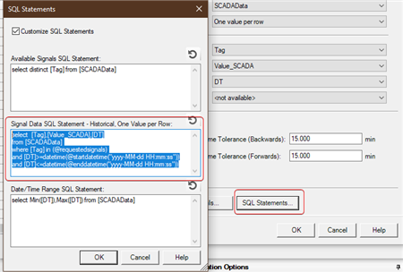

Additional Settings
In the advanced settings in the Database connection window, select Single Quotes, for SQL Date / Time Query delimiters (the default value is #).
Update SQL Statements as shown below
The column names, Tag, Value, and the DateTime might be different from database to database (as per your database created). Based on the way datetime is stored in the database, the query below might need some adjustment, see the “yyyy-MM-dd HH:mm:ss” part.
select  [tag],[Value],[DateTime]
from [SCADAData]
where [tag] in (@requestedsignals)
and [DateTime]>=datetime(@startdatetime("yyyy-MM-dd HH:mm:ss"))
and [DateTime]<=datetime(@enddatetime("yyyy-MM-dd HH:mm:ss"))

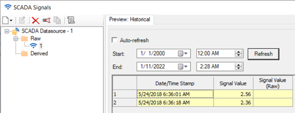

With these changes you should be able to import data from a SQLITE database using SCADAConnect.
