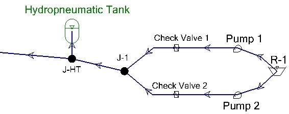

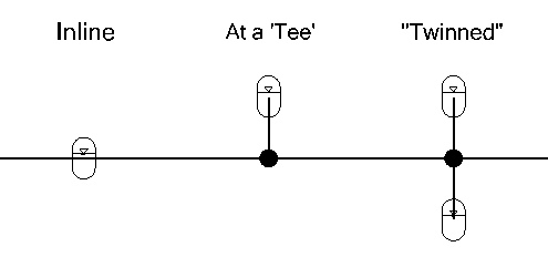

Location
A hydropneumatic tank is typically installed just downstream of a pump station, in order to keep the water column moving after a pump shutdown event. It is typically installed inside an enclosed building and is sometimes 'twinned' (two of the same tank side by side) for maintenance and redundancy purposes.3
If the hydropneumatic tank location is uncertain or if more than one may be required, you can compute the transient simulation without any protection and check your results, such as the minimum and maximum pressure envelope in the Transient Results Viewer. By viewing these results, you can see critical areas of the pipeline and potentially find a good location for the hydropneumatic tanks. You can then add your hydropneumatic tanks, re-compute the transient simulation, re-check the results and make adjustments as necessary.
Note: Sometimes a tank may be required on the suction side of a pump station as well, to prevent cavitation upon pump shutdown/startup. Be sure to check the minimum pressure results upstream of the pump for your transient simulation.
The pipe connecting from the main pipeline to the hydropneumatic tank can be modeled in HAMMER either implicitly or explicitly. Basically, when laying out the hydropneumatic tank, it can be modeled at a 'Tee' by laying out the connecting pipe, or can be modeled directly on the main line. When modeling on the main line (which is the typical approach), the influence of the short piping between the main and the tank can be represented by means of the tank inlet diameter and minor loss coefficient fields.
Although explicitly entering the short connecting pipes to the vessel is not incorrect in principle, it may lead to excessive adjustments in pipe length or wave speed which in turn may have an impact on the results. This adjustment commonly occurs with short pipes, due to the fact that HAMMER must have a wave able to travel from one end of the pipe to the other end in even multiples of the time step. Since you can model the connecting pipe head losses via the minor loss coefficient field, it is often best to model the tank inline. However, you must also consider the effects of water momentum. For example, if you are modeling large flows and large diameter pipes, the effects of accelerating that relatively large volume of water in the connecting pipe upon emergency pump shut down may be significant.

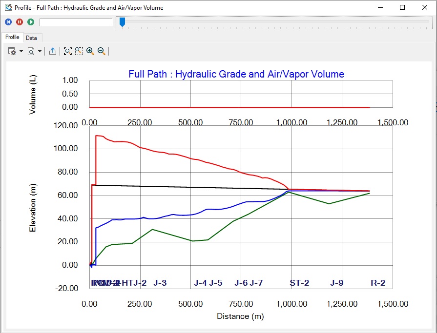

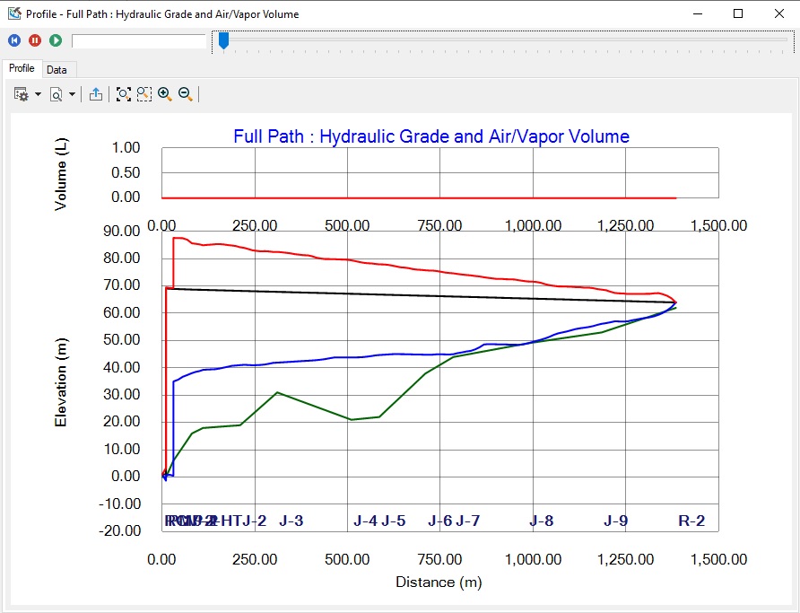

If you are simulating an emergency pump shutdown event, it may be possible to have a condition where a single hydropneumatic tank at the pump station cannot provide adequate protection. For example, if there is an intermediate high point between the pump and the downstream boundary tank or reservoir, even if your initial hydropneumatic tank pressure is high, it will eventually drain down to a hydraulic grade that causes sub-atmospheric pressure at the high point. So, it is important to also consider the length of time that the pump will be shut down. You will likely want to simulate the worst case scenario, so in this situation you may need additional protection, such as an air valve or additional tank near the high point. For example, consider the following pipeline profile with an emergency pump shutdown:
Dark black line = physical elevation.
Dashed black line = steady state / initial conditions head.
In the screenshot above, the addition of a hydropneumatic tank (gas vessel) just downstream of the pump station does not offer enough protection. Sub-atmospheric pressure occurs at the downstream end of the system, due to the high point. Even with an air valve at the high point, the longer the pump is off, the more air will be introduced into the system. The addition of a surge tank at the high point, as shown in the screenshot below, does well at alleviating this problem.
Note: It is important to note that using hydropneumatic tanks and surge tanks in treated drinking water systems can result in water quality deterioration and loss of disinfectant residual. These devices should be equipped with a mechanism for circulating the water to keep it fresh. A further complication occurs when the tanks are located in cold climates where the water can freeze. If freezing is an issue, smaller hydropneumatic tanks that can be housed in heated buildings are preferable.1

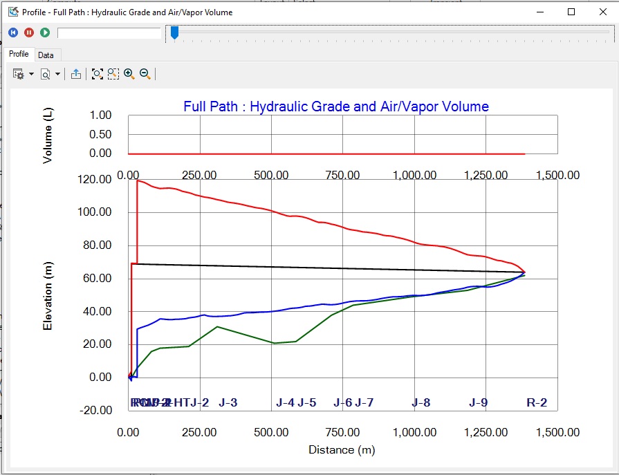

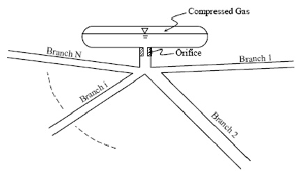

Differential Orifice
The piping connection between the hydropneumatic tank and the system should be sized to provide adequate hydraulic capacity when the chamber is discharging, as well as to cause a headloss sufficient to dissipate transient energy and prevent the chamber from filling too quickly. Both of these requirements are met through the use of a piping bypass as depicted below.1
In HAMMER, the headlosses associated with this can be modeled by using the "Minor Loss Coefficient," "Ratio Of Losses," and "Diameter (Tank Inlet Orifice)" attributes of the hydropneumatic tank. This is referred to as the differential orifice, because the ratio of losses allows you to have the inflow headlosses different from the outflow headlosses. In the above illustration, you can see that the check valve causes inflows to undergo larger headlosses as water passes through the bypass. So, the ratio of losses attribute is usually larger than 1.0 and applies to inflows.
The minor loss coefficient that you enter is used for tank outflows. For tank inflows, the minor loss coefficient is multiplied by the ratio of losses and the resulting coefficient is used. The effect of a differential orifice can be large for some systems.
Note: You may consider adjusting the minor loss coefficient to represent multiple losses through the tank assembly. For example, you may have minor losses from bends, fittings, the tank inlet itself and the differential orifice assembly. In this case, you can set the "minor loss coefficient" value to represent all those losses, but remember that the velocity used to calculate them is based on the area of the "diameter (tank inlet)". Also, you'll need to set up the ratio of losses such that the losses through the entire tank assembly appropriately accounts for the additional loss through the bypass of the differential orifice.
Consider the two profiles below, showing the maximum transient head for a pipeline during an emergency pump shutdown event. The first profile shows the results without a differential orifice applied; the orifice diameter is 175 mm with a ration of losses set to 1.0. The second profile includes an orifice of 100 mm and a ratio of losses set to 2.5. As you can see, it helps reduce the maximum transient pressures in the system. This could also mean a possible reduction in total required tank size.

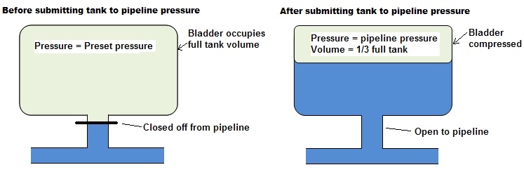

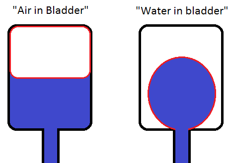

Bladder
A flexible and expandable bladder is sometimes used to keep the gas and fluid separate in the hydropneumatic tank. Since there is no contact between the compressed air and the water, there is no dissolution. There is thus no requirement for a permanent regulation system such as an air compressor, which is otherwise typically required (since the gas slowly dissolves into the water).2
In most cases the bladder "balloon" contains the gas, but in other cases, the gas is in the area between the tank casing and a bladder that surrounds where the water from the main flows in and out (meaning "water in bladder" as opposed to "air in bladder"). For transient modeling in HAMMER, this is not a factor, since there is still a certain volume of gas and a gas/pressure relationship that determines the change in pressure due to a change in volume and vice versa.
When using a bladder, a 'pre-charge' pressure is first applied, before the tank is connected to the system and submitted to pipeline pressure. Normally the pre-charge is done to a bladder "balloon" containing the air or gas, but in the aforementioned "water in bladder" case, the pre-charge is done to the area between the bladder membrane and the tank walls. However in both cases, the pre-charge will result in gas occupying the entire tank volume (V) at a certain pressure (P), which HAMMER uses (with the gas law) to determine how pressure and volume change during the transient simulation. For example, based on the hydraulic grade in the initial conditions in HAMMER, it uses that pre-charge pressure paired with the total tank volume to determine how much the area where the gas resides is compressed.
Transient protection performance when using a bladder-type tank tends to be sensitive to the pre-charge pressure, since it determines the initial gas volume and sensitivity to pressure changes. Sometimes you may have a requirement on the pre-charge pressure, such as being 5% of the normal pipeline pressure. Otherwise, you may need to use trial-and-error to find the best pre-charge pressure.
When using the bladder tank option, prior to and during a transient computation:
After the simulation is complete, you can look in the text output files to see what the preset pressure, pre-transient volume (at system pressure) and subsequent variations in pressure and volume have occurred.
Note: The pre-Charge pressure i.e. Pressure (Gas-Preset) needs to be defined in terms of Gauge pressure. During calculations, atmospheric pressure is added which then becomes absolute pressure, which is required for the Gas law calculations. The hydropneumatic tank gas pressure results are reported in terms of absolute pressure. An example calculation for this is shown in the below section "With Bladder"; please refer to that for an illustration.
More on how Bladder-based tanks work can be found further below under the section "Transient simulation behavior".

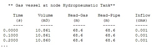

The transient simulation uses the hydraulic grade from the initial conditions, along with the initial gas volume, which is either user-entered (if "Treat as Junction" = True) or calculated based on the difference between the "Volume (Tank)" and "Liquid Volume (Initial)" (if "Treat as Junction" = False). As pressure in the system drops due to a downsurge, this gas volume expands and water injects into the system. Pressure upsurges cause the gas to compress as water re-enters the tank. This compression and expansion occurs in accordance with the isothermal gas law. A constant number of moles / mass of gas in the tank and constant temperature is assumed, so the 'nRT' term in the gas law equation is replaced by a constant, K. Thus, the equation used is PVk=K, Where P = absolute pressure (feet or meters), V = gas volume (cubic feet or cubic meters) and k is the Gas Law Exponent specified in the tank properties. Thus, the constant K is computed from the initial gas volume raised to the exponent, multiplied by the initial pressure. The pressure P is the initial hydraulic grade minus the tank physical elevation, plus atmospheric pressure (1 atm or 10.33 meters). This way, a new air volume can be computed based on pressure changes during the transient simulation.
For example, consider a tank where the initial gas volume is 0.8 m3 , initial hydraulic grade is 150 m, physical elevation is 100 m and gas law exponent is 1.1. From this, HAMMER computes the "K" constant as: (150 - 100 + 10.33)(0.81.1) = 47.2. Since K is known now, the change in pressure can be computed based on changes in volume due to inflow or outflow. If the tank filled such that the gas volume was compressed to 0.5 m3 , based on the K constant of 47.2, this means that the corresponding pressure = (47.2) / (0.51.1) = 101.175 - 10.33 = 90.845 m and a hydraulic grade of 100 + 90.845 = 190.845 m.
Note: In the formula above, the pressure P is measured from the bottom of the tank (the physical elevation). This is because by default, HAMMER does not track the liquid level in the hydropneumatic tank. This assumption should be fine in most cases, because these tanks are usually relatively small and thus the change in liquid level would have a minimal impact. However if you would like HAMMER to be able to account for the liquid level (water height), check out the section further down in the TechNote called "Tracking the Liquid Level."
Note: In HAMMER 08.11.01.32 and greater, the "Volume of gas (Initial)" field only needs to be entered if your hydropneumatic tank is treated as a junction or if you are choosing to specify custom initial conditions (and are not using a bladder). In other cases, the initial gas volume is derived from the total tank volume minus the initial liquid volume.
A note on pressure at an empty condition: A gas pressure of zero does not necessarily correlate to when the tank becomes empty. The gas in the tank may still be pressurized when the gas volume exceeds the size of the tank, or when the water level in the tank reaches the bottom (if using "Variable Elevation" for the Elevation Type). This also means that you can have a situation where a tank is not yet empty when the gas pressure drops to zero.
If you use the variable elevation table as the elevation type, the water level can be calculated for a more accurate calculation of pressure (based on the water surface elevation instead of based on the tank physical "elevation"), but the situation is still the same, in that the gas pressure is calculated based on the gas law relationship.
For example, consider a case where the model reports a maximum volume of gas that is slightly less than the total tank volume, yet the minimum pressure of gas is reported as 6 m absolute (or -4.3 gage pressure). In this case, the results indicate that when the hydraulic grade drops to the bottom of the tank, the gas volume is still greater than the full tank size and the tank is not yet empty. The HGL then drops below the bottom and the tank is still not quite empty of water. This basically means that there is a negative pressure in the almost-empty tank, which can be imagined as the water column "pulling" at gas pocket inside the tank. In a practical sense, this may mean that the initial gas volume is too small for the given initial pressure. However, if increased, that changes the pressure vs. flow relationship and the tank may become empty.

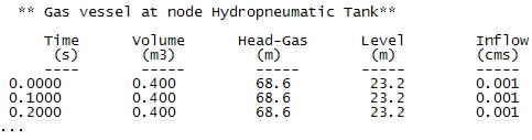

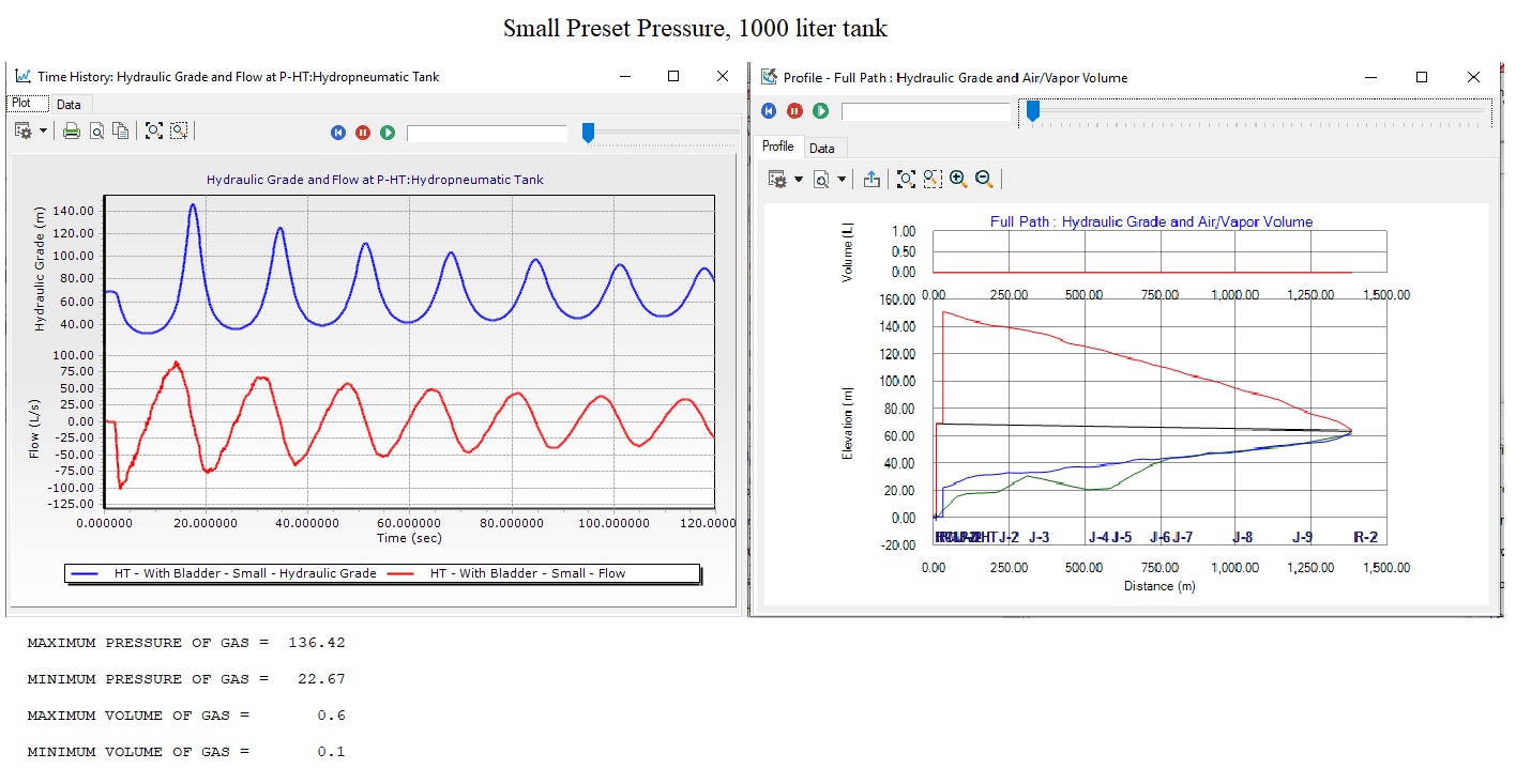

With a Bladder
If your hydropneumatic tank has its gas contained within a bladder (or in some cases the water is contained in the bladder and gas is between the bladder and the tank wall), then you must enter a gas preset pressure. This is the pressure inside the bladder (or more specifically the area where the air/gas is contained) before the tank is submitted to pipeline pressure; basically the pressure that you precharge it to, before installation. The preset pressure is typically a percentage of the pipeline pressure; a possible range is 5% to 80%. Since the tank is not yet installed when the bladder is precharged, it means that the gas takes up the entire tank volume. (Note that this is the case even with "water in bladder" cases, where the gas is contained in the area between the bladder membrane and the tank walls.) So, HAMMER can calculate the initial gas volume inside the bladder (when submitted to pipeline pressure) based on the full tank volume, the preset pressure and the pipeline hydraulic grade. First, the constant K in the gas law (PV = K) is computed based on this preset pressure and the full tank volume, "Volume (Tank)." The transient simulation's initial gas volume is then computed based on the K constant and the initial conditions hydraulic grade. The initial conditions hydraulic grade is either the user-entered value in the "HGL (Initial)" field or the computed steady state hydraulic grade, depending on the "Treat as Junction?" selection.
For example, consider a tank that has been given a full volume of 500 L and the initial conditions pressure head is 50 m. Assume that the pre-charge pressure is 5% of the steady state pipeline pressure. (This is a number that you would know ahead of time.) So, the gas preset pressure is set to 2.5 m (50 m times 5%). In this case, HAMMER computes the 'K' constant as (2.5 m + 10.33 m)(0.5 m3) = 6.415. Since K is known now, the initial gas volume for the transient simulation after the bladder is submitted to pipeline pressure is computed as V = K/P = (6.415)/(50 m+10.33 m) = 0.106 m3 = 106 L. Note that the pressure head (50 m in this example) is based on the difference between the initial hydraulic grade and the tank "Elevation" when the tank type is "fixed". However when using the variable elevation option (and when using the 2023 of HAMMER or later) the pressure head calculations are based on the difference between the initial HGL and the water surface elevation (calculated iteratively based on the variable elevation curve and the gas volume).
Conversely, consider a case where you want the tank's bladder to be compressed to a specific size when submitted to pipeline pressure (rather than assuming a percentage of pipeline pressure such as 5%) and would like to know what you would need to enter for the preset pressure to achieve this. Assuming the same full tank volume/size of 500 L, the initial conditions pressure head of 50 m (this assumption only works with the "Fixed" tank type - see more below), and assuming you want the bladder to be compressed to an initial gas volume of 200 L, we must calculate the K constant based on the gas law when the tank is installed, where the "P" is the initial pipeline pressure (50m) and the "V" is the desired gas volume of 200 L (0.2 m^3) : K = (50m+10.33m)*0.2m^3 = 12.066. Next, take this "K" and calculate the preset pressure that the bladder would need to be charged to before installed, where the bladder occupies the full volume (500L / 0.5 m^3). The gas law equation can be rearranged in this case, to P=K/V : P = (12.066 / 0.5 m^3)-10.33 = 13.8 m. So, you would need to use a preset pressure of 13.8 m to achieve an initial gas volume of 200 L, in a system where the initial pipeline pressure is 50 m and the full tank volume is 500 L. Please note that if you are using the "variable elevation" tank type, this simple hand calculation would not be possible, because the initial pressure P is not a fixed value (tank "elevation") but rather it changes depending on the gas volume which changes the water surface elevation. So, an iterative calculation is necessary. You would need to make an initial estimate of the preset pressure for your desired initial gas volume, then view the starting gas volume from the Extended Node Data tab of the Transient Results Viewer, adjust the preset pressure, compute again, observe the new starting gas volume and repeat as needed.
Note:
To see the initial gas volume in the bladder at the start of a transient simulation, ensure that text reports are enabled in the calculation options and a number is entered for the "Report Period" of the tank, then look at the bottom of Reports > Transient Reports > Transient Analysis Detailed Report. At the top of the table of results for the tank, note the volume for time zero. This is the initial gas volume - the compressed size of the bladder.

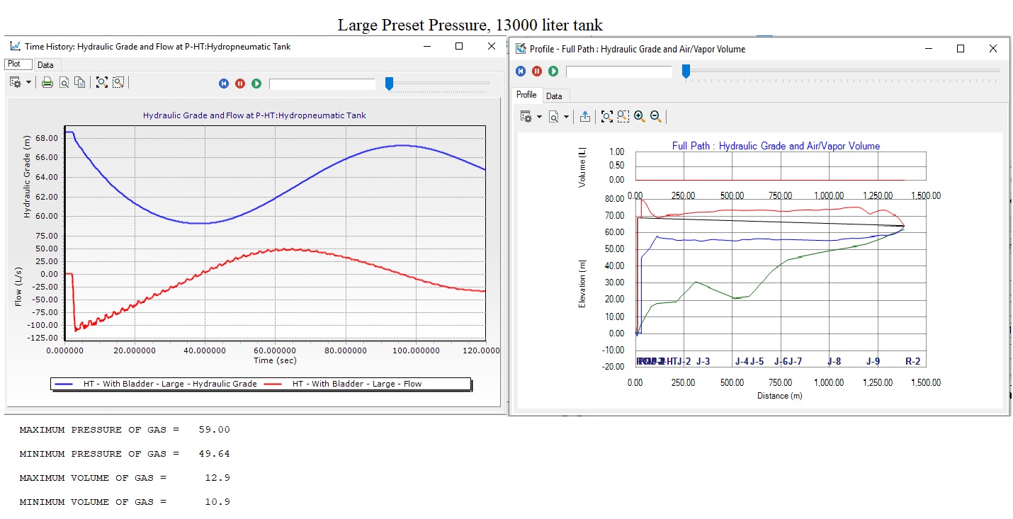

Intuitively, as long as the gas preset pressure is lower than the pipeline pressure in steady state, the initial volume of gas in the tank will be less than the total volume. Typically, the preset pressure is relatively small, but that may not always be the case. Below is a comparison of two possible bladder tank configurations (at opposite extremes of the spectrum) for a particular system, with an emergency pump shut down event.
Observe the graph of time vs. head at the tank location, summary of min/max gas pressure (in meters) and gas volume (in cubic meters) along with transient profile envelope (blue line is minimum head, red line is maximum head.)
In the first case, the pre-charge pressure is small compared to the pipeline pressure, with a 1000 L tank. In the second case, the pre-charge pressure is large compared to the pipeline pressure, with a 13,000 L tank. With a low preset pressure, the bladder is initially compressed to a relatively small size. So, it is less likely for the tank to drain completely, and thus a relatively small tank size is used without becoming empty. However, per the gas law, the rate of pressure decrease will be higher for a vessel with a lower preset pressure. So, the graph and profile show minimum and maximum transient pressures that may be too extreme for this system. On the other hand, with the high preset pressure case, the bladder is not compressed much when submitted to pipeline pressure. So, a much larger tank size is required to prevent the entire tank from draining of water. However, in contrast to the low preset pressure case, the minimum and maximum transient pressures are much more reasonable. As you can see, the modeler needs to closely examine what is happening in the results for certain tank configurations. Testing different preset pressure values is something you can easily do in HAMMER to see the effects of either option. The text output logs can show you the gas volumes are pressures during your simulation.
Note: Remember that HAMMER assumes that the size of your hydropneumatic tank is large enough so that it does not become completely empty. So, regardless of whether you are using a bladder or not, if the volume of gas exceeds the total tank volume during the transient simulation, a notification will be displayed, but gas volumes above the total tank/bladder volume will still be calculated since HAMMER cannot model an empty tank. A gas volume in excess of tank volume tells you is that the tank you used is not sufficient and you will likely need to consider a different preset pressure, larger tank, different configuration, additional protection, etc. For more explanation about this, see: Hydropneumatic tank user notifications: "gas volume exceeds volume of tank" or "fills its containing tank"

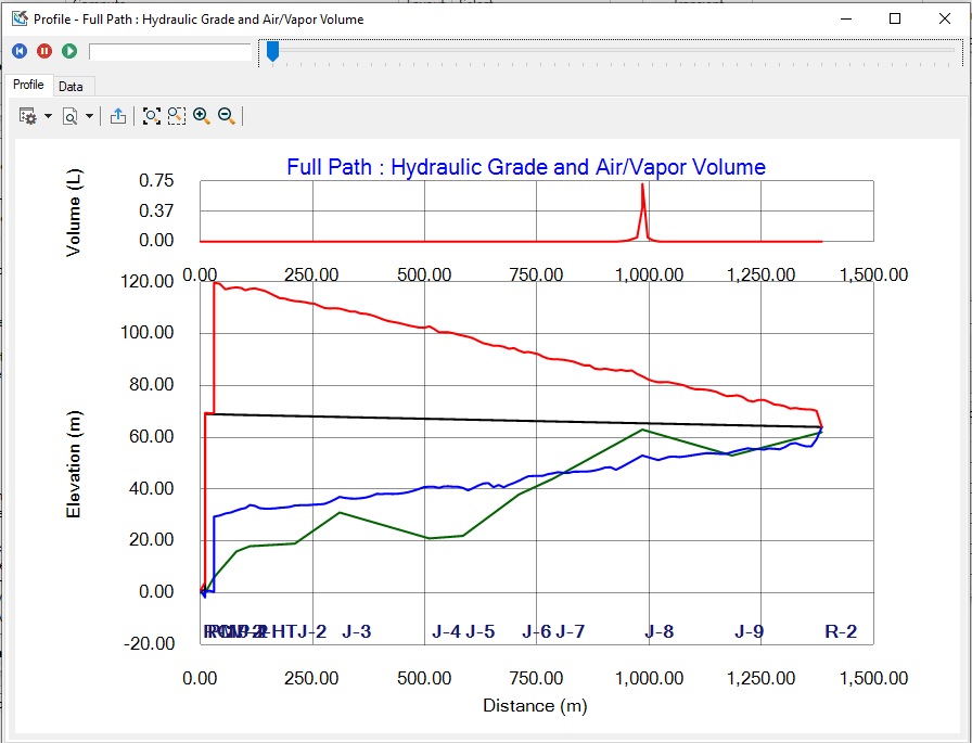

There are many ways to view the results of your transient simulation. For a hydropneumatic tank, some results are available in the powerful Transient Results Viewer tool and some are found in the text output.
Note: Do not confuse initial conditions results with transient results. The result fields in the "Results" section of the hydropneumatic tank properties pertain to the initial conditions calculations only. For example, if you right click the tank, choose "Graph" and choose "Gas Volume (Calculated)," this will not show you the gas volume during the transient simulation.It will be for the initial conditions results only.
The primary tool for viewing results is the Transient Results Viewer. To prepare for its use, first ensure that your transient calculation options are set up correctly (Home > (Calculation) Options or Analysis > (Calculation) Options). Choose some elements under "Report points," choose the desired report times and select "True" for "Generate Animation Data." Next, create a profile of your pipeline under View > Profiles. Then, compute your model and go to Home > Transient Results Viewer or Analysis > Transient Results Viewer.
To see the transient envelope, select your profile path and click "Plot." To see how the head and vapor volume changes over time throughout your profile, click the "Animate" button and use the animation controls. This will give you a good visualization of how the hydropneumatic tank performs. To see graphs of HGL, flow, and/or vapor volume over time, select one of your report points under "Time Histories," select the attribute to graph and click plot. For example, you may want to see the flow and head at the hydropneumatic tank location.
Note: the volume reported in the Transient Results Viewer is only air or gas introduced into the pipeline. It does not show the volume of gas inside the hydropneumatic tank itself. The same applies to the "Air Volume (Maximum, Transient)" field shown in the "Results (Transient)" section of the hydropneumatic tank properties.

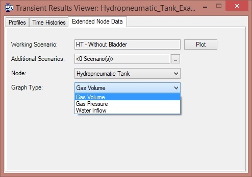

Beginning with HAMMER V8i SELECTseries 5, additional results are available in the Transient Results Viewer. These were previously only available in text reports. For hydropneumatic tanks, the results available depend on the type of tank (for example dipping tube vs. regular sealed tank):
Gas volume - the volume of gas trapped inside the tank. Increases as water drains from the tank.
Gas pressure - the pressure of the gas in the tank, as measured from the tank bottom (physical elevation), or from the water surface if using the variable elevation curve option.
Water level - the water surface elevation inside the tank - available for dipping tube type tanks for example, where the "variable elevation curve" is used to define the tank dimensions.
Water inflow - the flow rate of water into the tank. Negative values indicate water outflow (leaving the tank)
To access these, choose the Extended Node Data tab in the Transient Results Viewer.

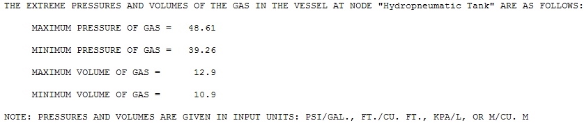

HAMMER's text output results also offer important information for hydropneumatic tanks. To prepare for viewing this information, first check your transient calculation options. "Show standard output log" and "Enable Text Reports" should be set to "True". Next, enter a number for the "Report Period" field of your hydropneumatic tank. This represents how often extended text results will be reported. For example, if your time step is 0.01 seconds and you enter '10' for the report period, it means you'll see extended text results every 10 time steps or every 0.1 seconds.
As mentioned above, some of these results are available in the Extended Node Data tab in the Transient Results Viewer. For users with older versions of HAMMER, they will still need to use the steps below to view the results.
The first text report of importance is the Transient Analysis Output Log, under Report > Transient Reports. Scroll down to the section starting with "THE EXTREME PRESSURES AND VOLUMES". This part of the report summarizes the maximum and minimum gas pressure and volume for the transient simulation.
Lastly, to see a table of extended hydropneumatic tank results, open the Transient Analysis Detailed Report, under Report > Transient Analysis Reports. Scroll down near the bottom, to the section starting with " ** Gas vessel at node" and you will find a table of gas volume, tank hydraulic grade, pipeline hydraulic grade and tank inflow, over time. The difference between the "head-gas" and "head-pipe" is the headloss induced by the minor loss coefficient at the tank's connecting pipe. Negative values for "inflow" represent tank outflow.
See also: Differences in hydropneumatic tank gas pressure results

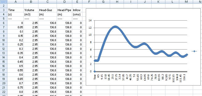

Starting in HAMMER V8i SELECTseries 5, this data can now be viewed directly from the Extended Node Data tab in the Transient Results Viewer. If you have an older version of HAMMER, you must manually generate a graph using an external application such as Microsoft Excel. Here are the steps, assuming Microsoft Excel 2007:
  1. Highlight the table of extended results, then copy/paste it into a separate .txt file (using Windows Notepad).
  2. Open Microsoft Excel and start a new spreadsheet.
  3. Click the "Data" tab, choose "From Text", then select your file.
  4. Choose "Fixed width", then "next".
  5. Set up the field widths so that the columns of data are separated appropriately.
  6. Set up a line graph with the appropriate columns (Time, plus whatever attribute you'd like to graph. For example, volume of air)

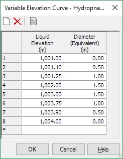

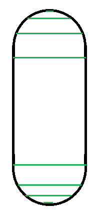

Variable Elevation
Selecting "Variable Elevation" exposes the "Variable Elevation Curve" field, which enables you to enter a table of liquid elevation versus equivalent diameter. The variable level hydropneumatic tank type is for users who have detailed information about the tank's geometry (such as a cylinder / curved ends) and want to perform as accurate a simulation as possible. Typically, this type of representation would be selected in the detailed design stage. It would also be appropriate in the case of low-pressure systems and/or relatively tall tanks with large movements of the interface relative to the HGL of the gas. The initial liquid level is determined from the initial gas volume which is an input parameter. The tank cross-sectional area at any elevation is interpolated from an input table of the vessel's geometry spanning the range from the pipe connection at the bottom to the top of the tank. The equivalent diameters would be the green lines in the below example illustration:
After computing the transient simulation with a variable elevation hydropneumatic tank, you can view the liquid level over time by looking at the Transient Analysis Detailed Report. This report is found under Report > Transient Analysis Reports and will show this extended, tabular data for the tank when you've entered a value for the "Report Period" property of that tank (see "Text Reports" further above).

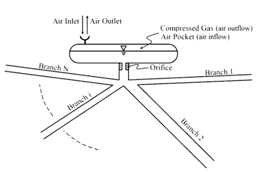

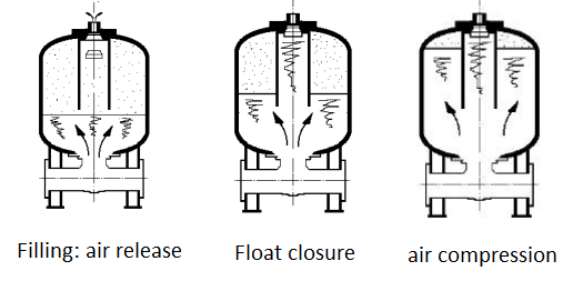

Vented Vessels
This type of hydropneumatic tank has a double-acting air valve that admits air into the system from the atmosphere, when the tank drops below atmospheric pressure (Walski, 2007). A vented hydropneumatic tank is effectively a sealed tank with the addition of an air valve at the top. This allows air at atmospheric pressure to enter the tank during a downsurge so that the device behaves like a one-way surge tank. During an upsurge, the air valve typically throttles the air outflow so that the gas within the tank is compressed and acts as a 'cushion' against transients (just like a sealed hydropneumatic tank). This device offers several practical benefits - for example since the tank typically has no gas inside, there is no need for compressors or a bladder to ensure a required gas volume is maintained.
Note:

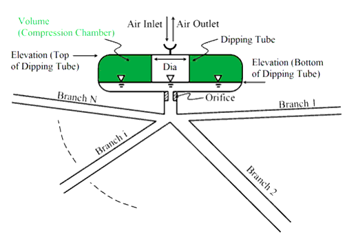

Dipping Tube Vessel
A dipping tube hydropneumatic tank has a dipping (or ventilation) tube inside with an air valve at the top. One of the main advantage of the dipping tube tank is that it does not require a compressor or a bladder.
During normal operation the air valve is closed, the water level is above the bottom of the dipping tube, and gas is compressed in the compression chamber. If the hydraulic grade line drops, such as after a pump shutdown), the dipping tube tank acts like a regular (sealed) hydropneumatic tank until the water surface drops below the bottom of the dipping tube, after which the air valve opens and allows air to enter at atmospheric pressure. The air flow rate is reported in the text reports. At this point, the tank is acting like a surge tank that is open to atmosphere. If the hydraulic grade line increases again, such as the pumps turning back on), air will be expelled until the hydraulic grade line rises enough to close the air valve. At this point the water surface will be above the bottom of the dipping tube and the tank will act like a regular sealed hydropneumatic tank once again, as the air/gas is trapped in the area around the dipping tube, known as the compression chamber. HAMMER uses the air inflow orifice diameter for the air venting calculation.
For a Dipping tube hydropneumatic tank, the tank elevation-area curve is used to calculate the tank volume. Before the air in the dipping tube tank is compressed, the air volume is the tank volume above the bottom elevation of the dipping tube. When the air is compressed, the gas law equation and the Newton iteration method is used to calculate the water level and air volume in the tank. Using the gas law equation, an iterative Newton method is used to calculate the water level in the tank. In the gas law equation calculation, the pressure of the air is Atmospheric pressure + pressure head - level.
Note: In HAMMER version 2026 and higher, a new "Air Flow Calculation Method" can be found in the transient calculation options, where you can choose between two different methods of calculating air flow rate, which applies to both air valve and hydropneumatic tanks (vented or dipping tube).
To calculate the initial air (gas) volume, the elevation-area curve is used, along with the initial HGL and the elevation of the bottom of the dipping tube.
The "Volume of Gas (initial)" field is required if you are choosing "true" for "treat as junction?" - when "true" is selected, it means that you want the tank to "float" on the system during the initial conditions (pressure in the tank settles to be equal to the normal pipeline pressure). The "volume of gas (initial)" in that case is the volume that the trapped gas compresses to when the pressure inside the tank is equal to the initial conditions pressure. To determine the initial gas volume, one possible option to consider is to use the gas law PV=nrt (simplified to PV=K) to calculate that initial gas volume based on the initial conditions pressure (P - be sure to add atmospheric pressure) and the compression chamber volume (V). Since compression only starts to occur when the water level rises to the bottom of the dipping tube, you can use the full compression chamber volume for the initial gas law calculation, with an initial pressure of zero (zero gage, 1.0 absolute), calculate the "K", then use the gas law equation again with the initial conditions pressure P (expressed in absolute pressure) , the K you first calculated, and solve for V for the initial gas volume that the chamber compresses to at that pressure.

The Variable Elevation curve represents the full size of the tank, so you do not need to exclude the dipping tube volume.The volume of the dipping tube is automatically excluded from the volume of the compression chamber.
The compression chamber volume is derived from the elevation-area table and dipping tube size and the "Volume (Compression Chamber)" is for reference purposes. You may see a user notification if there is a discrepancy.
The calculated gas volume for a dipping tube hydropneumatic tank includes the gas volume in the compression chamber and the gas volume in dipping tube. Note that when the water level is above the bottom of the dipping tube, the compressed gas/air is only contained within the compression chamber (green shaded area in the diagram below), and accordingly the gas law calculations exclude the volume of the dipping tube.
Addition information can be found here: https://charlattereservoirs.fayat.com/en/services/solutions/waste-water-range/araa-self-regulating-water-hammer-protection-tank  (see video at top)
Additional Notes and Troubleshooting for Dipping Tube tanks:
Example Model
The model below is an example of the use of the Hydropneumatic tank in HAMMER and has several scenarios for different configurations. This sample model is included with the HAMMER installation. You can find it in the Sample folder of the installation folder.
Note:
