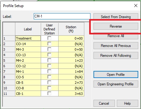

How can i reverse the direction of profile view?
Problem ID#: 41748
The appearance of the profile will be from left to right in the order you select the elements. It is possible to reverse the profile appearance if you want to change how it is displayed.
For all OpenFlows products, you can do this from the Profiles manager. To open the Profiles manager to to View > Profiles (in the storm and sewer products, you can also go to Home > Profile). Right-click on a profile and choose Edit. In the Profile Setup window, you can select the Reverse option, which will reverse the direction of the profile.

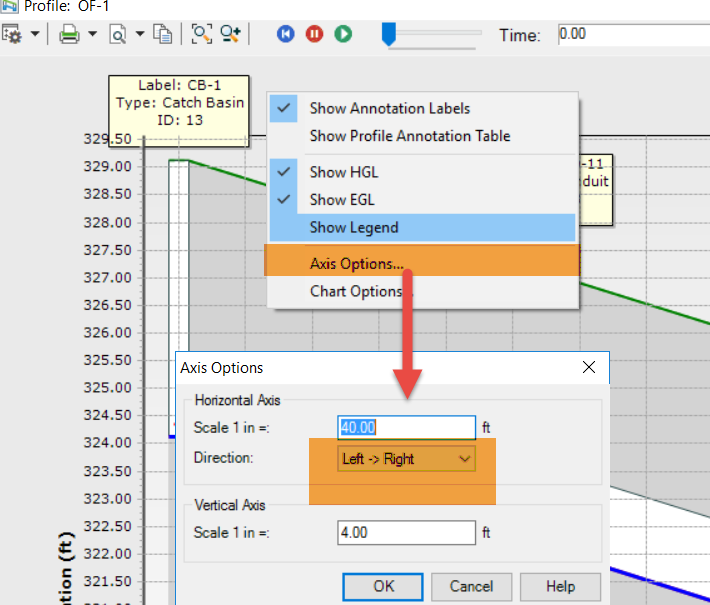

If you are using the storm and sewer products, you can also open the profile, then right-click in the profile window, then select Axis options, You can change the direction by choose Left>Right or Right>Left, then click OK
