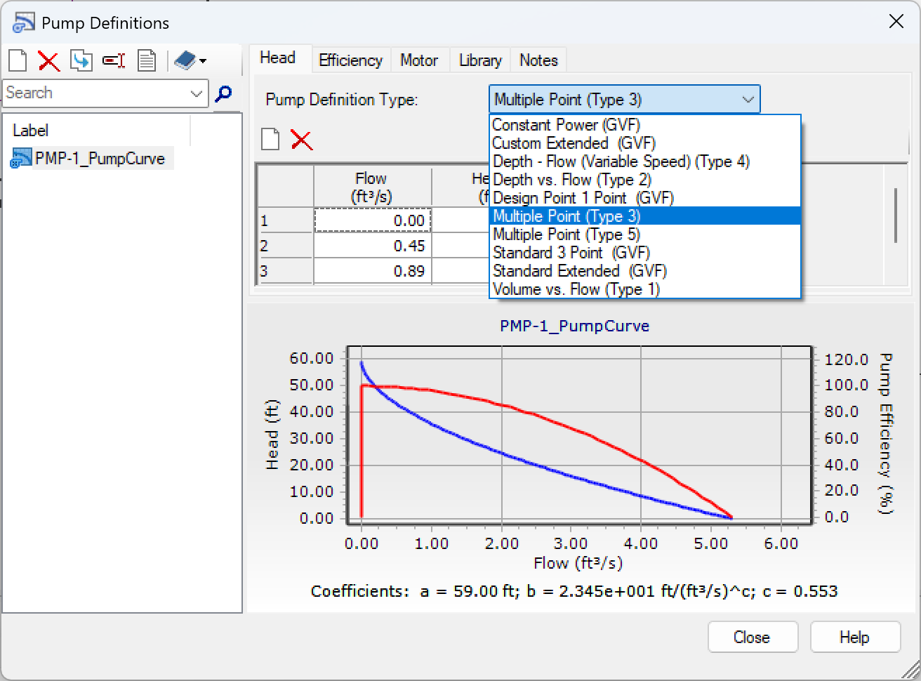

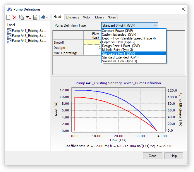

There are many types of pump definitions in Bentley storm and sanitary sewer models. These pump definitions are established by going to Components > Pump Definitions. These definitions can be assigned to any pump element. Pump definitions contain the pump curves describing pump performance. The only curve that is mandatory for modeling a pump is the head curve. Efficiency and motor curves are only used in Bentley water models.
Some of the definitions are used only in the implicit and explicit dynamic wave solvers and are not supported with the GVF-Convex (SewerCAD) solver. The table below shows pump definition type compatibility and was last updated in May of 2026, as of version 2026 (26.00.00.514):

Constant Power type, Custom Extended, Design Point 1 Point, Standard 3 Point and Standard Extended type pump data are converted into a multiple point curve of 20 points for use during calculations with the Implicit and Explicit solvers.
