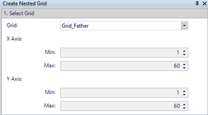

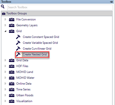

The first step to nest a sub-domain is to create a nested grid. OpenFlows FLOOD has a specific tool to create a nested grid which refines the horizontal resolution of a parent grid In the Map Window, and loads the parent domain Grid layer (which was used to create the parent domain Grid Data bathymetry file). Then go to Tools -> Grid -> Create Nested Grid.
This will open the tool docked on the right-hand side of the Map Window. In step 1 select the parent domain grid from the drop-down list.

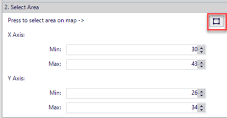

In step 2, select the button shown below.

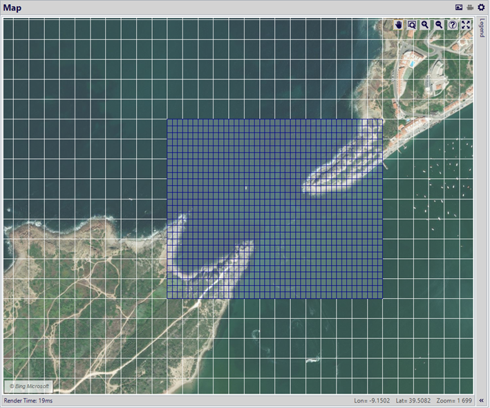

Then click and hold the mouse button over the map and draw a rectangle of the area where you want to refine the horizontal resolution of the parent grid. Release the mouse button to set the rectangle final area and a refined grid will appear in the map, as shown below. You can adjust the final location of the grid by changing the X and Y axis minimum and maximum grid indexes as shown in the image above.
Keep in mind that, generally the sub-model grid should be contained in the parent grid (there are some exceptions, but mostly it should be kept inside the parent’s grid). Also, avoid placing the open boundary of the sub-model grid over intertidal areas as this can bring some inconsistencies in some types of applications. If this is not possible to avoid, there are tools to help keep the consistency between the parent and child models.

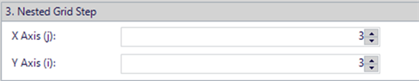

Once the sub-model area is defined you can increase the resolution ratio between the parent and child grids. The default and recommended ratio is 1:3 and should never be more than 1:5.

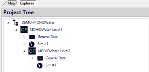

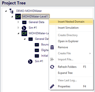

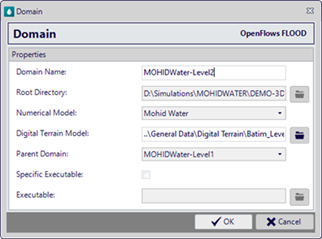

After setting up, and calibrating and validating the parent domain, in OpenFlows FLOOD’s Explorer window select in the parent domain in the tree view. Right click and select “Insert Nested Domain”.
Then provide a name for the nested sub-domain and define the path to the child domain bathymetry Grid Data file.
You can notice that the “Numerical Model” and the “Root Directory” are automatically handled by FLOOD and cannot be edited. Also, the “Parent Domain” field is now populated with the name of the corresponding parent domain. Press OK and a new nested domain is created in the domains/simulations tree view as shown below (parent Level 1 and child Level 2) and then select the nested domain, right-click and insert a new simulation.

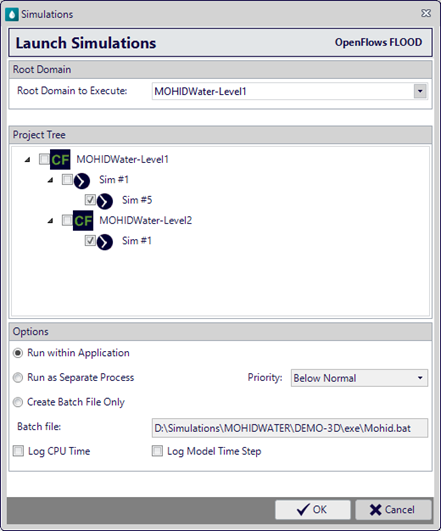

Once the child domain simulation is setup, to compute the parent and child simulations using nesting approach go to Execute Models tab and click Schedule.
The following dialog will appear.
Select the root domain to execute and in the project tree, select parent and child simulations check boxes. Finally press OK to start the simulation.
