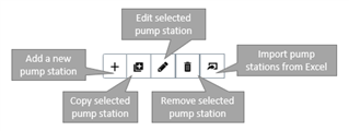

Administration page used to import pump station information into WaterSight. Pumps are associated to a particular pump station using the Pump Configuration page.
It is possible to import pump station information through a configuration Excel file (template file available for download in the Digital Twin Setup page) or to manually add a pump station and its characteristics. After uploading pump station information, it is also possible to edit, delete or copy information, using the available buttons located above the table.
Note: To enable the Copy, Edit, and Remove options, please select a pump first (row in the table). When clicking in a specific pump station (table row) the fields available for editing will appear below the pump station configuration table.
