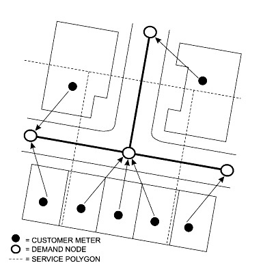

Billing Meter Aggregation: This method assign all meters within a service polygon to a specified demand node, as shown in the screenshot below.
The service area is typically generated using the Thiessen polygon tool available in the product. Whatever billing meter points fall within the service area will be added as a demand to that service area’s corresponding junction.
Here is a link with some example files: Billing Meter Aggregation Example Files. These can be used with the WaterGEMS and WaterCAD sample files Example3.wtg.

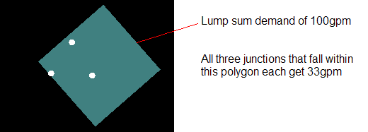

Equal Flow Distribution: This method equally divides the total flow contained in a flow boundary polygon and assigns it to the nodes that fall within the flow boundary polygon. For example, if the polygon represents 100 gpm and three junctions fall within it, they’ll get 33 gpm each.
Equal Flow Distribution Example files

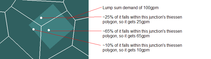

Proportional Distribution by Area: Uses a service area layer (typically generated using the Thiessen polygon tool) which represents the service area around each junction, along with billing meter polygons with a single demand value. The demand assigned to the junction is based on how much of the flow polygon is overlapping it’s service area. For example, if 25% of the 100 gpm demand polygon falls within a junction’s Thiessen polygon, then that junction will get 25 gpm.
Proportional Distribution by Area Example

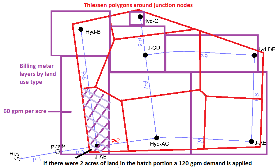

Projection by Land use (Storm-Sewer products)/Load Estimation by Land Use (Water products): Uses a Thiessen polygon (service area layer) and layer of polygons that represent billing meter areas and their associated land use type. The user enters a guess of how much demand per acre is associated with each land use type and based on each polygon’s size, it will then have a specific demand value. This is distributed to the junctions in the same way as with Proportional Distribution By area. In the image below the portions of the purple land use areas that intersect the red Thiessen polygon service areas would determine the value of the demand that is applied to the nodes (junction, manholes, catch basins, etc.).
Projection by Land Use Example
