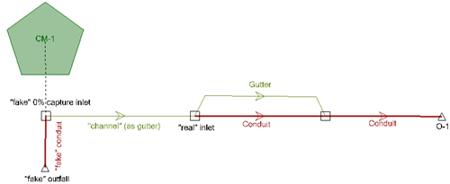

Modeling a Ditch (or channel) as a Gutter to Capture Runoff
If the ditch is used as a gutter to convey runoff between catchbasins (inlets), it would be modeled as a gutter between the catchbasins elements that represent the inlets. You would use the Ditch inlet type by selecting Catalog Inlet as the Inlet Type in the catchbasin properties, then enter an inlet in the Inlet Catalog with the Inlet Type set to Ditch. For the Gutter Shape in the catchbasin properties, you would select Trapezoidal and enter the dimensions. In the attached gutter properties, you could either define that as trapezoidal as well, or select the option to set the gutter type as "same as start node".
If the runoff enters on the upstream side of the ditch/channel, you cannot simply use a cross section element upstream of the gutter link element - it will need to start with a catchbasin node element. If you do not have an actual catchbasin there, you can configure it as a "fake" catchbasin with "percent capture" set as the inlet capture type, with a capture efficiency of 0% (or something very low like 0.001%) As seen in the below illustration. In this case however, it may be best to consider not explicitly modeling those upstream elements at all and rather have the catchment connect directly to the catchbasin element – the gutter geometry is built into the catchbasin element and when you see the calculated depth and spread at that catchbasin, it is based on the gutter geometry immediately upstream of the inlet opening (where they tend to be at their greatest, before some/all is captured). In other words, consider if there is value in modeling what happens in the channel between the immediate upstream side of the inlet and the point on the upstream of that gutter where the catchment flow enters.
Example model with both approaches (must use version 10.03.00.75 or greater):
Channel Flow approaching inlet example
