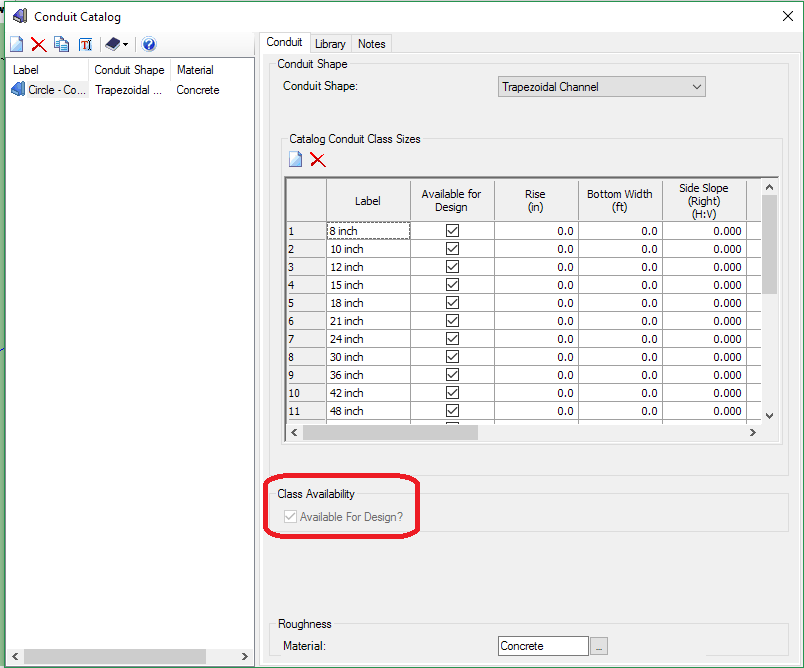

Furthermore, constraint based design of Conduit elements only supports certain closed cross section shapes. When in the Conduit Catalog, note the "available for design?" check box is grayed-out for open Conduit Shapes. As of version 2024, here are the available shapes that constraint based design can size:
Below is an illustration of an open-channel shape, where the constraint based design option is grayed out (not available).

*The class availability option may also be greyed out when the entire class is not available for import all at once, but the single entries for the shapes may be available for design.
