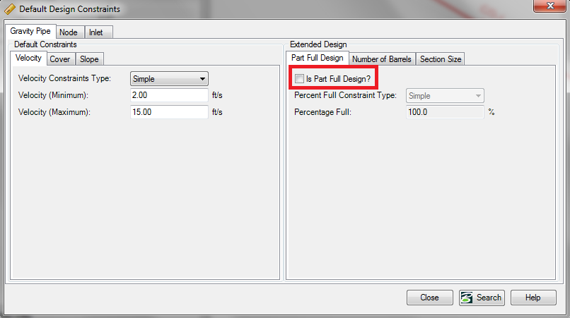

What is the difference between the Capacity(Design) and Capacity(Full Flow) results fields?
This user notification means that the flow through the conduit is greater than the theoretical (Normal Depth, Mannings equation-based) capacity that you are designing for, which is given in the Capacity(Design) field. If you are running an Analysis (as opposed to Design), this is just for reference purposes and may or may not indicate action needed (for example selecting a larger pipe size).
The constraint based design feature can also be used to size the pipes so this does happen (increase the pipe diameter until the flow is less than the design capacity). This is a high priority constraint as seen here. If you are using constraint based design (calculation type in the calculation options set to Design) and are seeing this notification, there are a few possible causes:
You may also notice that the same value is shown in both the "Capacity (Design)" and "Capacity (Full Flow)" fields. The difference between the two fields is that the Capacity (Design) can be a fraction of the Capacity (Full Flow) if the user has elected to do a "part full design". The default design options are set to design the pipe based on it being 100% full. This means selecting a pipe size at which the flow through the pipe is less than the Mannings-based flow through the pipe when the depth is equal to the rise (in other words the conduit is 100% full). In some cases, though you may want to design a conduit to a partially full value like 75% of the Capacity (Full Flow) of the conduit. This is done in the default design constraints manager, which can be accessed by going to Components > Default Design Constraints and clicking the check box for "Is Part Full Design?".
