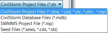

Unified Schema and One Common Data File Format
CivilStorm now uses file extension “.stsw” for new projects, and will automatically convert existing projects saved in earlier versions of CivilStorm that had used the old file extension (.swg).
In addition to CivilStorm projects, users now have the ability to open other Bentley storm and sewer ( SewerGEMS, StormCAD) projects within CivilStorm and save them in one common data file format.

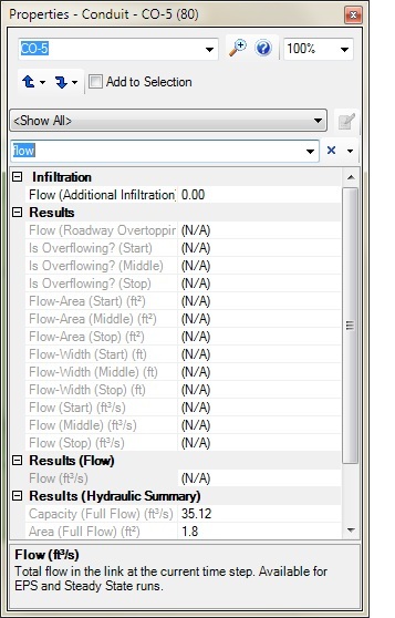

Keyword Search in Property Grid
Users can find the property they want quickly in the property grid using keyword search. To use this function, open the property grid for any element, by either double-clicking on the element or going to View > Properties. The new Property Search field is above the list of element properties. Simply start typing the word you are searching for and the property grid will dynamically filter to show any property field name that contains the phrase entered.
Recent searches are stored in the drop down selection. The search term is maintained even when selecting a different element or element type. To clear the selection, click the Clear button beside the drop down.

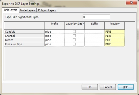

More user control in DXF export
CivilStorm now offers more control over layer/level assignment during DXF export. When you use the Export command, you first specify the drive, directory, and file name of the DXF file to be saved. Then the Export to DXF Layer Settings window opens, allowing you specify the names of the DXF layers on a per-element type basis.
The Export to DXF Layer Settings dialog is divided into tabs for Link Layers, Node Layers, and Polygon Layers.
Each tab contains a table that allows you to specify a prefix and suffix for the associated DXF layer. The Preview field displays how the label will appear.
Note that specifying a prefix or suffix also creates new layers for each prefix/suffix. If no prefix or suffix is specified all links, nodes, and polygons will be exported to the same DXF layer.
The Link Layers tab has additional controls: Entering a value in the Pipe Size Significant Digits field allows you to organize the pipe layer into multiple layers taking the pipe sizes into account using the Layer by Pipe Size checkbox.

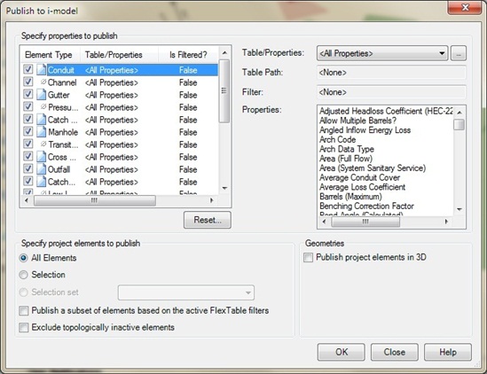

i-model publishing
With the SELECTseries 3 release of CivilStorm V8i, you can now publish an i-model. An i-model is an immutable container for rich multi-discipline information published from known sources in a known state at a known time.Basically it is a portable, read-only copy of a model file that can be viewed by users that do not have CivilStorm. The topology as well as the attributes and results (for a particular timestep) can be viewed in MicroStation, ProjectWise Navigator, and Bentley View. Since Bentley View is free, i-models provide a way for anyone to easily view data and results for a CivilStorm model file. Exporting to 3-D i-models is a part of this feature as well, allowing for a 3-D represenation of the the i-model in Bentley MicroStation or Bentley View.
Under File > Export, you will have a "Publish i-model" option, which requires the i-model publishing engine (downloadable from Bentley SELECTservices). The i-model publishing engine shows as a prerequisite on the download page for CivilStorm, but is only necessary if you intend to publish i-models. If you have no need to publish i-models, you do not need to download and install this optional component.

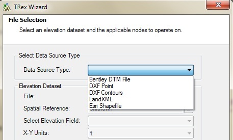

Bentley DTM support in TRex
In addition to previously supported file formats, the TRex tool in CivilStorm now supports the Bentley DTM file format. This is available through the Data Source Type pulldown.

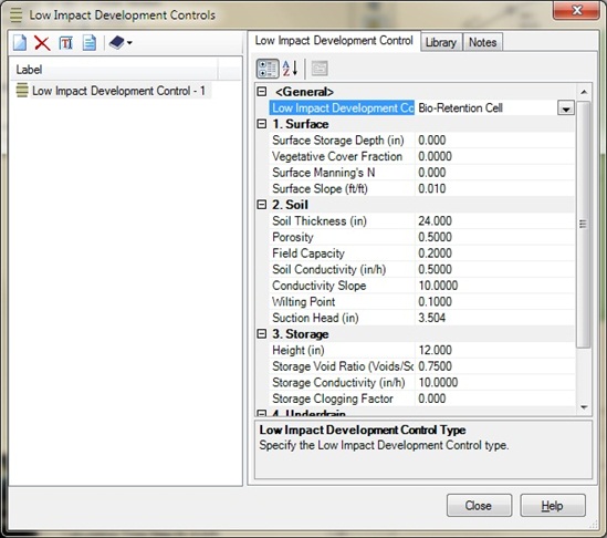

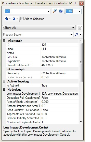

Low Impact Development (LID) elements
Low-impact development (LID) controls can now be analyzed in CivilStorm. Low-Impact Development (LID) is a term used in the US and Canada to describe a more eco-friendly land planning and design approach to stormwater management. In the United Kingdom, this approach is referred to sustainable urban drainage systems (SUDS), and in Australia, it's called water-sensitive urban design (WSUD). The US terminology is used in this software and its documentation.
LID controls help developed watersheds or sites to retain or enhance pre-development hydrologic characteristics through the use of techniques that conserve natural systems and hydrologic functions.
The basic steps to implementing LID controls in a hydrologic model are as follows.
Add generic LID controls to the project. This is done in the "Low Impact Development Controls Manager". There are a number of LID Control Types to choose from, each of which will have its own set of properties. The available types are Bio-Retention Cell, Infiltration Trench, Porous Pavement, Rain Barrel, and Vegetative Swale. Note that it is possible to change the default properties for these LID Control Types and assign new properties to the Engineering Library.
Next, add catchment and LID elements to the network drawing. Enter element-specific LID control and catchment data in the Properties pane. LID control attributes include designating a Parent Catchment and associating a generic LID. Proceed with the modeling project as you normally would (e.g., ente)r remaining network and rainfall data, configure storm data, run the model, review results).
Low-Impact Development (LID) controls as implemented in the software are based on the calculation methods used in EPA SWMM Version 5.0 and LID controls can only be used in conjunction with the EPA-SWMM Runoff Method.
A LID control element must be associated with a Parent Catchment. The Parent Catchment is the source of stormwater input to the LID control, and also receives discharge from the LID. The effect of a LID control on runoff is seen in the computed hydrograph for the LID control's Parent Catchment.

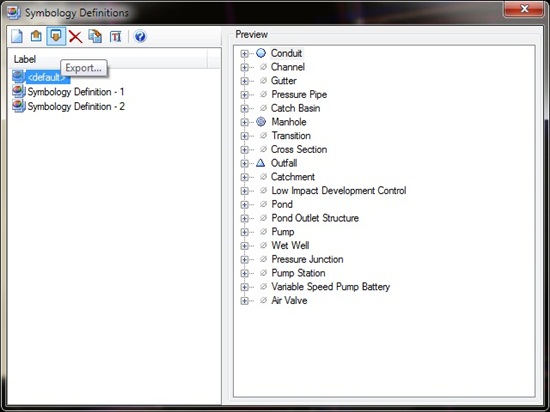

Improvements to Element Symbology
In the list of elements in Element Symbology, only those elements that are in the model will have their icons displayed. This will allow for the user to more efficiently work on annotations and color coding for presentation and results.
Copying and pasting of annotations and color coding are now available between different element types. To use this feature, right-click on the annotation of color coding you wish to copy, and choose Copy. Then right-click on the element you want the annotation or colory coding copied to and select Paste. The symbology will then appear with the new element type.
Symbology definitions can now be imported and exported to and from a model. To use click the ellipsis button beside the Symbology Definition drop down. To Export, click the "Export" button and give the file a name. The file extension is .SYM. This file can then be imported into another model by selecting the "Import" button in the Symbology Definition manager.
