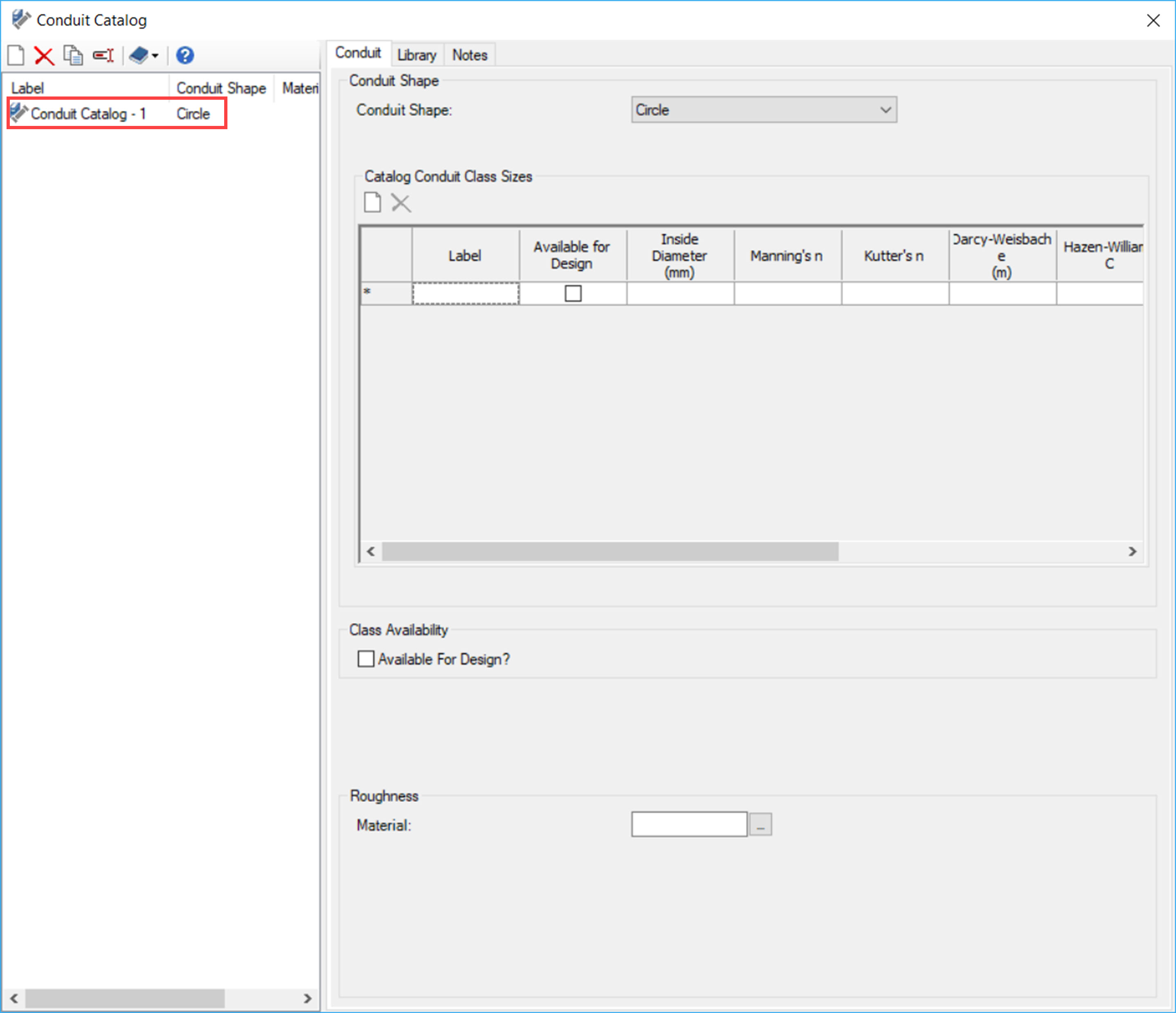

Go to Components>Catalog>Conduit Catalog (or for older versions such as V8i, Components>Conduit Catalog)
In the Conduit Catalog click on new to create new user defined shape.

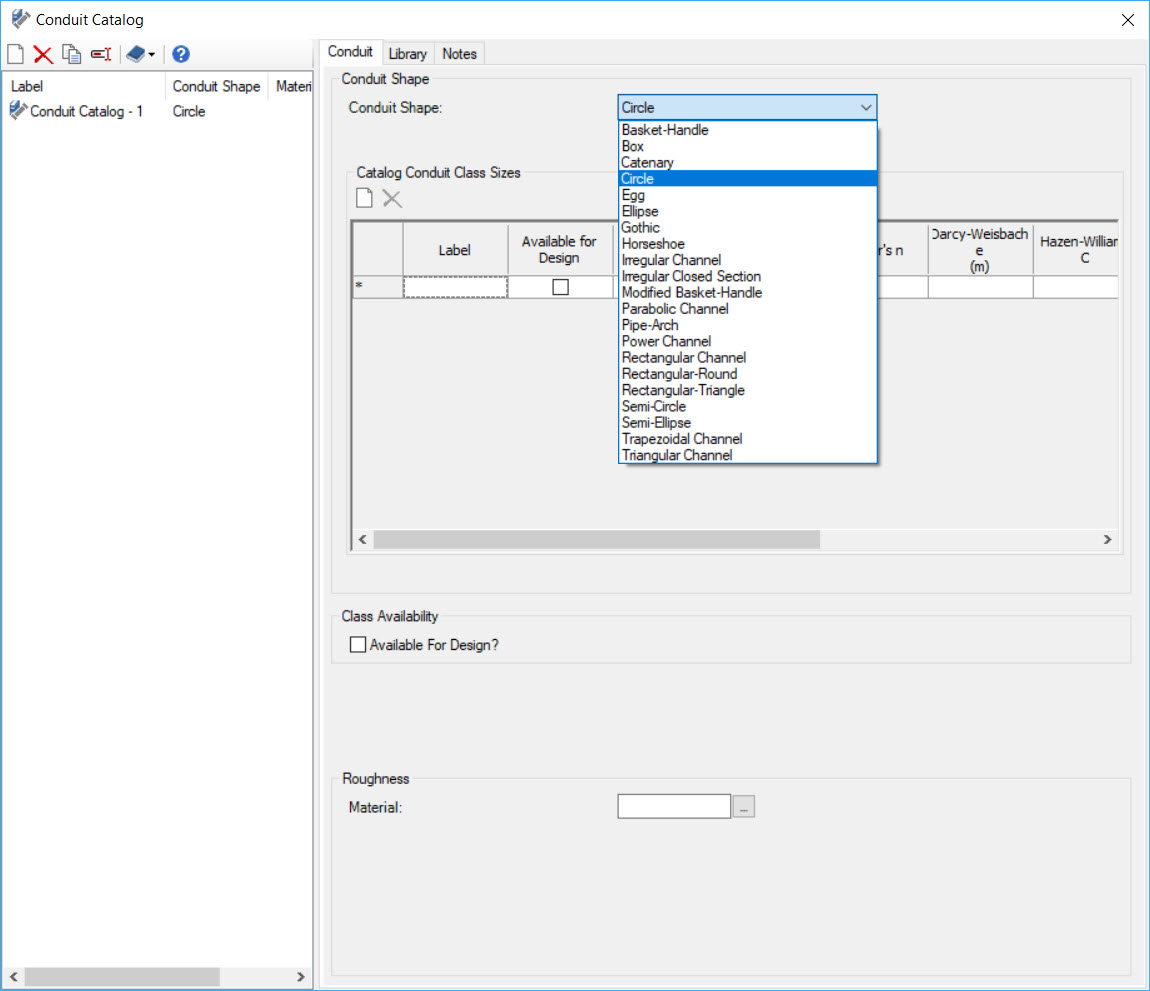

Click on Conduit Shape to select a shape to be assigned. Allowable conduit shapes include;
Additional information about all the available conduit shapes is provided in this wiki article and the Help section of the software.
Note that the Irregular Channel and Irregular Closed Channel options can be used to enter a custom station vs. elevation curve, enabling you to model any shape.
Input the geometrical parameters (height, span, width etc.) necessary to define the shape. For the irregular channel and irregular closed section options, you would define the rating table for your specific shape, which can be pasted in using CTRL+V if needed, from an external source.

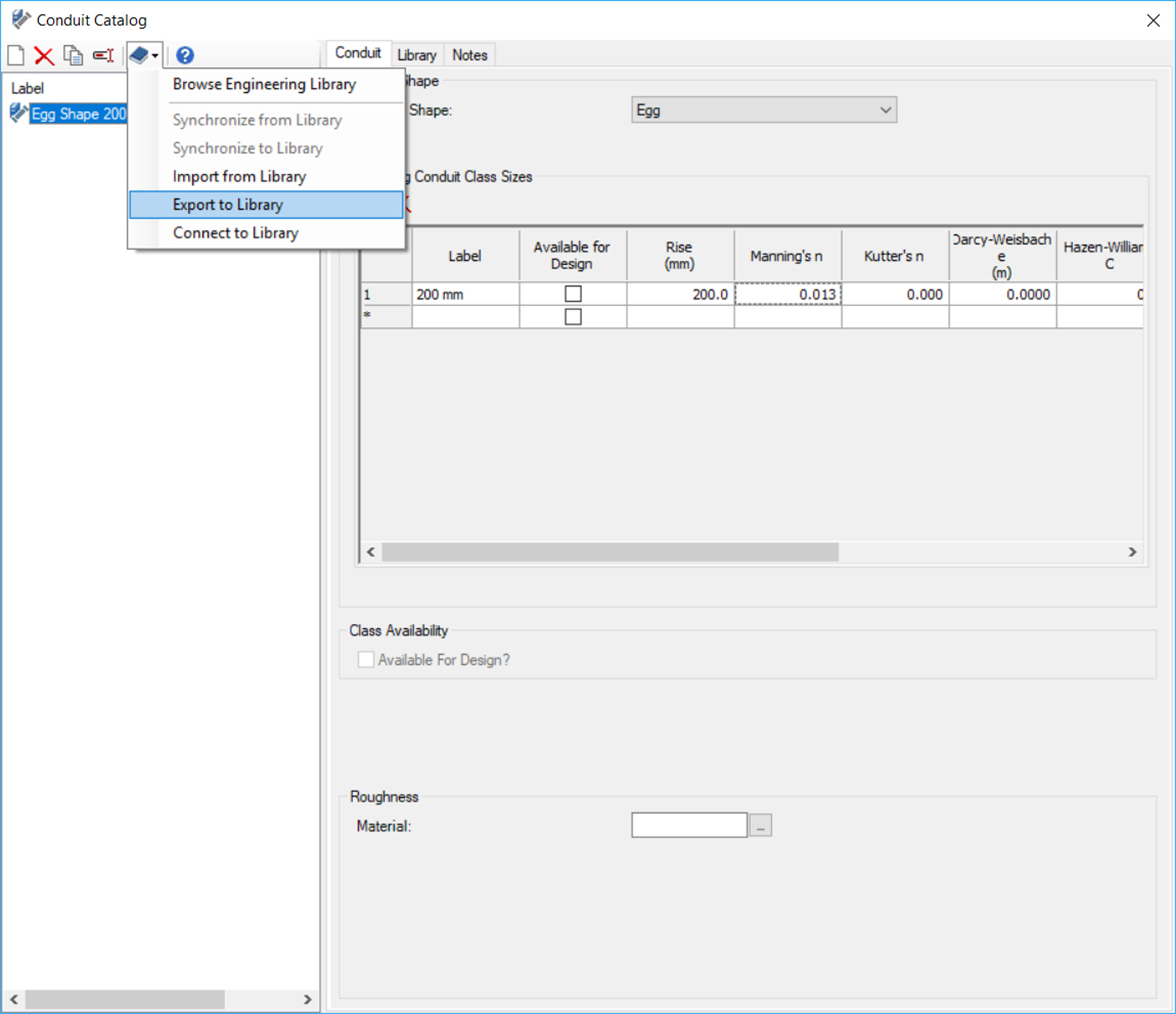

Once the shapes/size are created, if you would like to use them as standards for other projects, you can export them to the conduit engineering library. See more: Modifying and using Engineering Library Data
In the properties of your conduit or cross section, choose the Catalog as the type, then select the catalog class and size/material as applicable.
NOTE: if you were already using a catalog conduit and change the shape dropdown of the existing catalog class, you will either need to re-pick the Size from the conduit properties dropdown, or global edit from the flextables (otherwise the conduit will still show the old shape and dimensions, despite the numerical solver using the new shape and dimensions.
