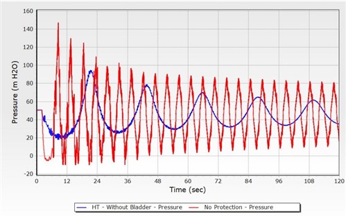

In the above figure, the red line shows the transient wave without any control while blue line shows the dampening of the wave with a pressure surge tank.

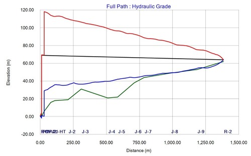

The above image is a profile showing the hydraulic grade line (HGL) which can be animated to show the fluctuations in pressure. The black line is the HGL before a sudden pump trip. The red line is the maximum HGL, the green line is the ground elevation while the blue line is the minimum HGL

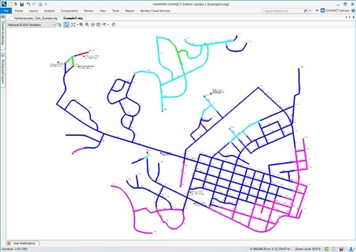

The HAMMER model of the above pipeline can be color coded based on maximum pressure over the course of a transient event with red being the highest and green the lowest.
