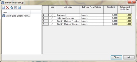

To begin, you need to set up the Extreme Flow. To do this, go to Components > Extreme Flows > Extreme Flow Setups (in V8i, the path is Components > Extreme Flow Setups).
To create a new Extreme Flow Setup, click the New button in the upper left. When you do this, a row will be added for each Unit Load associated with the model. You have the option to use a given load by placing a check box in the Use column. The other columns include the Extreme Flow Method and a couple of multiplier options.
There are a couple of options available to the extreme flow method. If you leave the Extreme Flow Method column set to "None" you can enter a constant. This is the multiplier that will be used on the loading derive from the Unit Load in the Sanitary Loading Control Center. However, you also have the ability to use one of several Extreme Flow Methods.

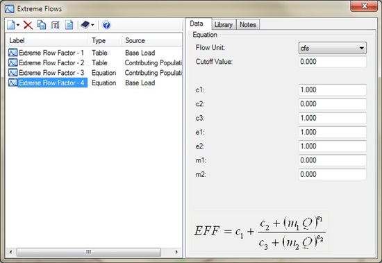

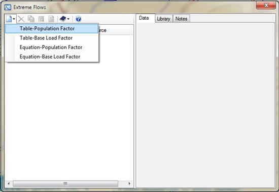

To create these, go to Components > Extreme Flows > Extreme Flows (in V8i, Components > Extreme Flows), or click the ellipsis button in the Extreme Flow Method cell in the Extreme Flow Setups dialog. Click the New button and choose from one of the four methods available.
If you choose the Table methods, you will have to manually enter the base load value or the population and the extreme flow factor associated with it. If you have a range of populations for each factor, enter a row in the table for the high and low point of the range. For example with the Table-Population method:
Note that the keyboard shortcuts work with this table, so if you have the table values in a format like Excel, you can copy and paste the data into the table.
If you choose the Equation methods, you will need to enter the coefficients for the equation. For convenience, the equation used to calculate the Extreme Flow Factor can be found at the bottom of the Extreme Flows dialog.

2) If you are using a Extreme Flow Equation type make sure to proper input a value to the "Cutoff Value" field. As explained here the Extreme Flow Cutoff should be > 0. The Cutoff Value is the maximum possible extreme flow factor (EFF) for peaking methods. This is used to prevent unrealistically high values for small populations or land areas.
Once you have created the Extreme Flows, you must apply it to the Unit Load. Return to the Extreme Flow Setups dialog. In the Extreme Flow Method, select the table- or equation-based method you wish to use. If there is an extra adjustment you need to apply, you can enter a value for the Adjustment Multiplier. The Adjustment Multiplier is applied to the load that has the Extreme Flow already applied. If you do not need to apply any extra adjustment, simply set the values in this column on 1.0.

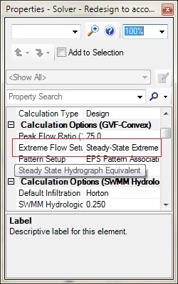

Now that the Extreme Flow Setups are completed, you need to apply them to the Calculation Option of the model. Go to Analysis > Calculation Options and double-click the active calculation option to view the properties. Find the properties field Extreme Flow Setup and set this to the Extreme Flow Setup you wish to use.
Now when you compute the model, the extreme flow setup will be applied to the loading of an element.
