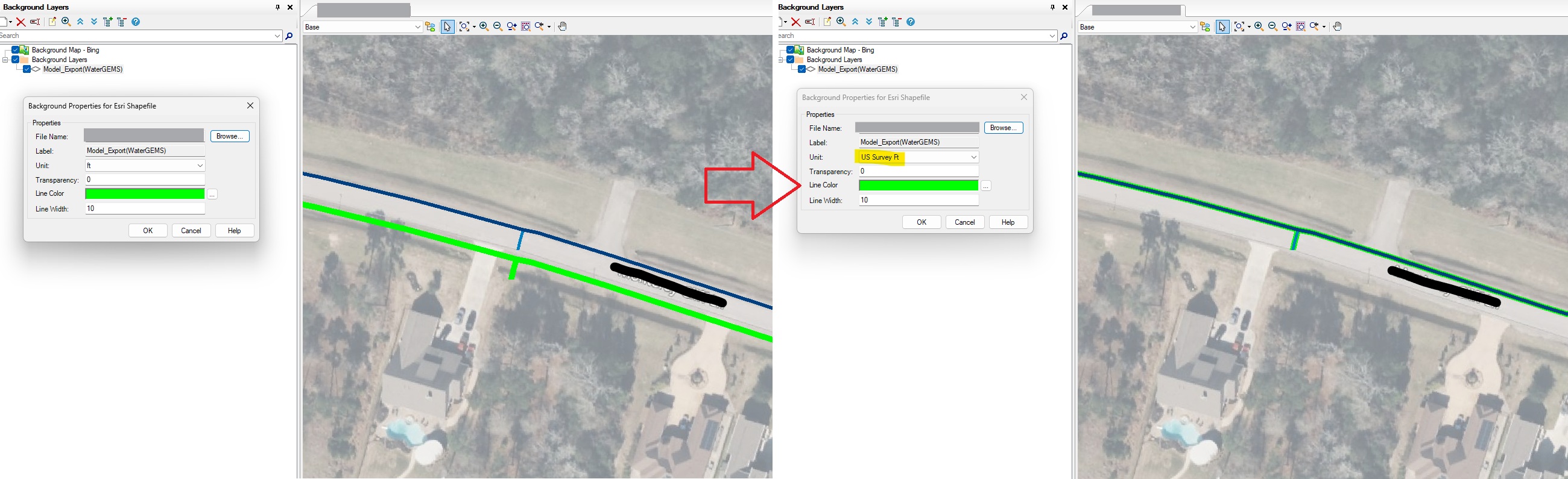

Note: for OpenFlows 2024 (Version 24.00.03.22) and earlier, when reimporting previously exported model elements as background layers, the background shapefile unit does not automatically update. You must manually adjust the unit to ensure proper alignment with your model. For example, if your model background map is set up as US Survey Feet, you will need to manually change the imported shapefile's unit to match the model coordinate system (as shown in the screenshot below).

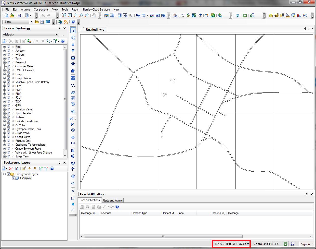

This could also occur if your model is located in a different place (based on the X/Y coordinates). Try going to View > Zoom > Zoom Center and zooming to a coordinate that you know is within the drawing. You could also bring the background file into a blank drawing and locate the center coordinates of the drawing that way. The coordinates in the standalone version of the software are shown in the location in the screen shot below. Once the coordinates are located you can use the Edit > 'Select All' feature or CTRL + A to select all the elements in your model and drag the model file over to a location of the background.
