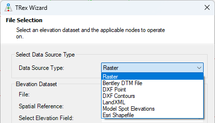

Support File Formats
The terrain / contour file format support depends on the platform that you are using.
Standalone and AutoCAD Platforms
- Raster: Raster image files: .tiff, .tif, .img, .adf, .asc, .dem, .xyz, .grd, .gpkg, .bil.
- Now available in the Standalone platform with version 24.00.03.XX and higher.
- Nearest neighbor and bilinear interpolation sampling methods are used. For more information visit the GDAL website.
- Trex assumes the Raster files only contain one band (elevation) and does not currently support files with multiple bands.
- Bentley DTM File:
- Inroads .dtm
- Geopack .tin (32-bit version only)
- Bentley MX .fil
- DXF Point: points containing elevation (Z) data. Interpolation is used to assign elevations based on proximity to the points.
- DXF Contours: polyline contour data.
- LandXML (.xml): LandXML contour data.
- Model Spot Elevations: similar to the DXF point method but uses the elevation (Z) of spot elevation node elements in the model.
- Esri Shapefile (.shp): point or polyline contour shapefiles.

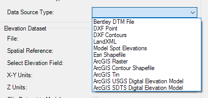

Esri ArcGIS platform
Additional:
- ArcGIS Raster (note: the Raster DEM support that was added to the Standalone version starting with 24.00.03.XX, will also be available in ArcGIS Pro starting with the v2025 release)
- ArcGIS Contour Shapefile
- ArcGIS TIN
- ArcGIS USGS DEM
- ArcGIS SDTS DEM

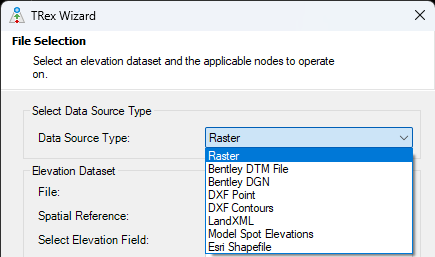

MicroStation Platform
Additional:
- Bentley DGN: terrain data contained within the active MicroStation DGN file. Note: terrain data in reference files is not currently supported (must be in the active model)

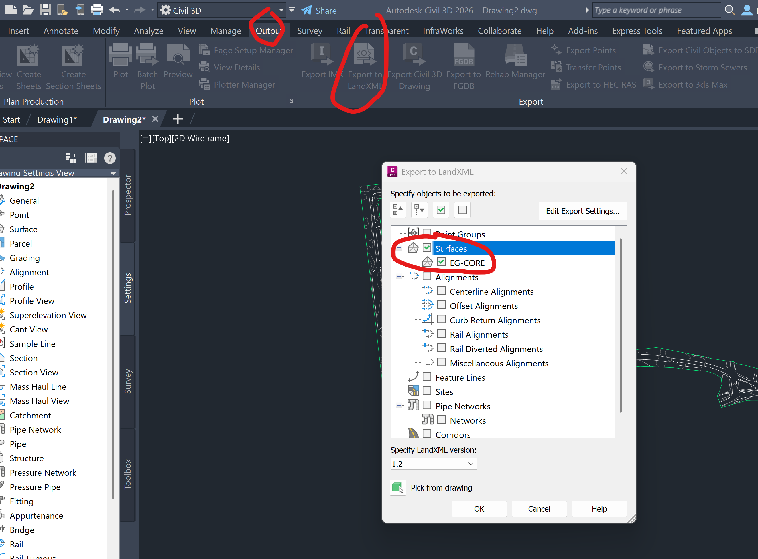

LandXML elevations added in TREX or TerrainModel does not match the elevations when opening the LandXML file in Civil 3D: The problem is that it's saving the LandXML file with layers other than the contour elevation lines. After importing the file into OpenFlows products, the elevations of the other elements will be taken into account for interpolation within the TREX or TerrainModel. Civil 3D can differentiate between layers and interpolate only the contour lines, but OpenFlows products cannot. Solution: In Civil 3D, export the LandXML file while selecting only the contour lines (see the screenshot below). Then, import it into OpenFlows.
