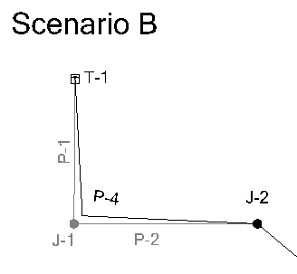

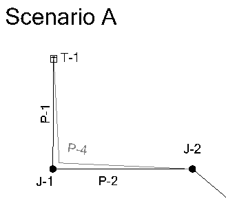

Example: delete J-1 in scenario B, using one pipe instead of two:
