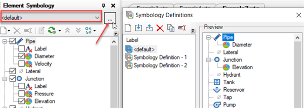

Element Symbology
The Element Symbology manager controls the way elements, and their associated labels are displayed in the drawing area. You can create multiple symbology definitions in which you can create different combinations of color coding and annotations for different scenarios and quickly switch between them.  The Symbology Definitions manager lets you add, edit, and remove and manage the symbology definitions associated with your model. To change the settings for a definition, change the current symbology definition to the one you want to edit in the Element Symbology Manager (using the dropdown at the top) and make the desired changes there (i.e. turn on/off the desired elements, create new annotations and color coding and turn them on or off, etc.).

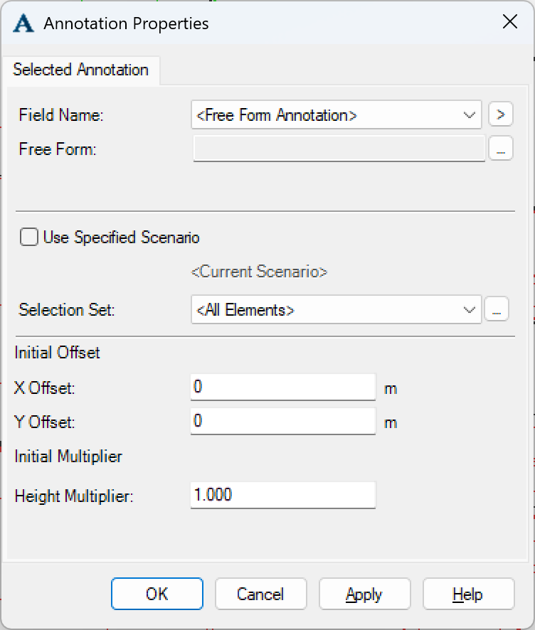

1) In the Element Symbology manager (View > Element Symbology) right click on the name of the element that you want to annotation and choose New > Annotation

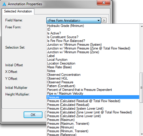

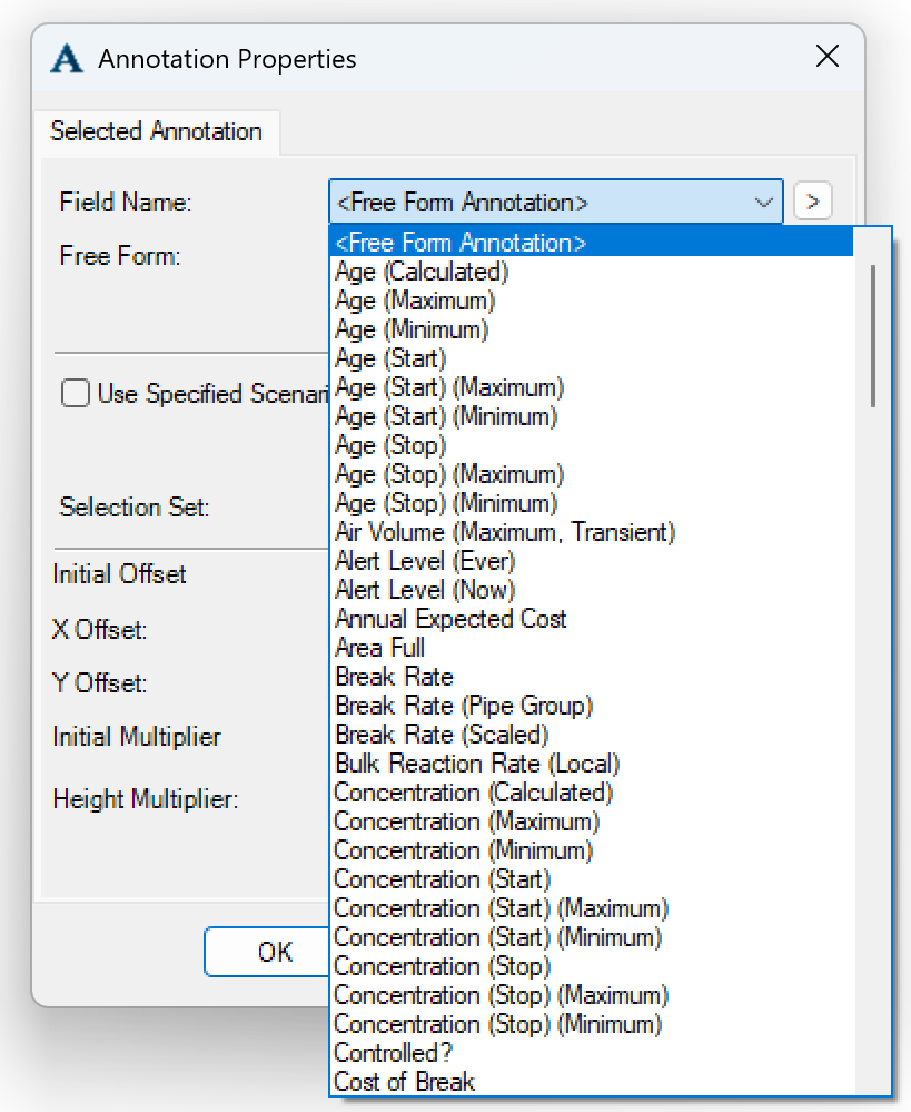

2) Choose the appropriate field using the drop down menu, which lists the properties in alphabetical order or select the field using the " > " button, which lists all the properties by category.
Note: Alternatively (instead of picking a single field to annotate), you can use Free Form annotations as described below.
3) After you choose all your setting (see details below) you can click "Apply" and then "Ok" to place the annotations.
After placement the annotations can always be moved manually by clicking and dragging the "handle bar" of the annotation.

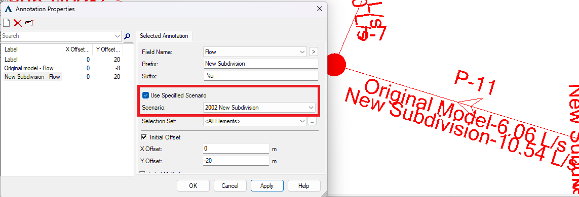

Annotation for a Specific Scenario
By default (and always, for version 2024 and earlier) annotations will reflect the currently active scenario. For example if you annotate pipe diameter and the diameter is different between two scenarios, the annotation will update to reflect the diameter of the active scenario, as you change from one to the other.
However, you may have a need to annotate for a specific scenario or more than one scenario (for example as a way to compare results between scenarios).
Starting with version 2026 (26.00.00.XXX and higher), this can be accomplished with the "Use Specified Scenario" check box. Notice in the screenshot bellow, two separate flow annotations were added, each with a specific scenario specified. In the plan view, the flow results are easily compared by looking at the two annotations:

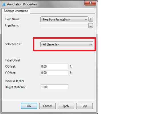

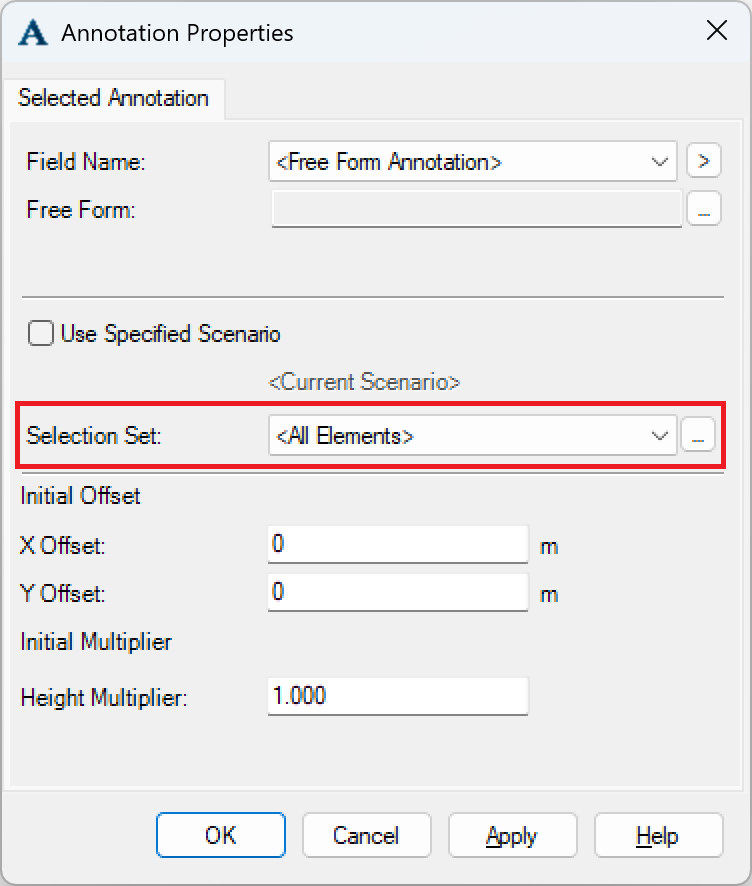

Annotating By Selection Set
The "Selection Set" dropdown enables you choose a existing selection set of elements that will be annotated. With this, you can annotate only certain elements in your model instead of all of them.

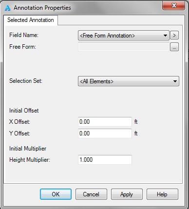

Setting the Offset and Size
The "X Offset" and "Y Offset" are used to adjust the initial placement offset of the annotations with respect to the center point of the element. The height multiplier is used to adjust the initial size of the annotation. This height multiplier is multiplied to the global height setting for annotations that is found on the Drawing tab in the Options manager (File > Options).
If you have multiple annotations for a given element type, it may be easier to use free form annotations as described further above.

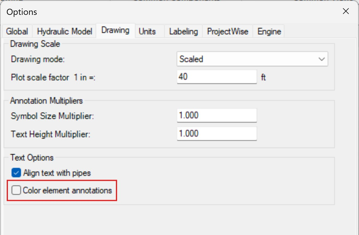

Annotation in default color and only color-code element symbology
If you want to keep the annotations (labels) in their default color and only color-code your element symbology (for example change the pipe colors without changing the color of the labels or annotations), go to File > Options > Drawing and uncheck 'Color element annotations'. Then click 'OK':

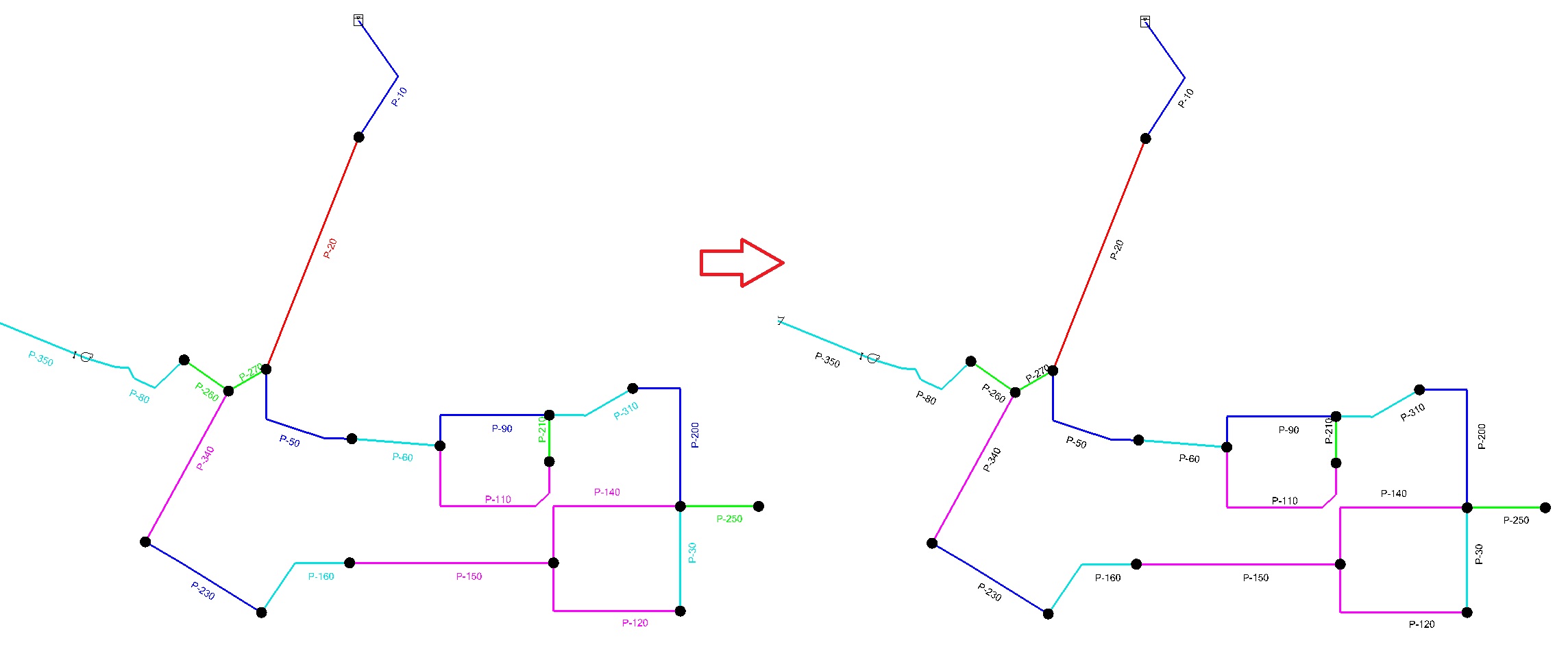

Re-aligning annotations to pipe orientation
